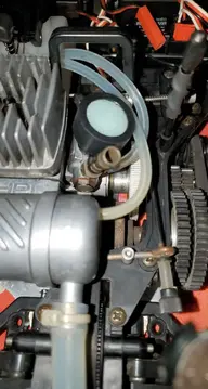

Alcohol and Q-tips. I take the engine and fuel tank out first. Gets it looking brand new, but takes a long time. I'm weird though, and enjoy cleaning them almost as much as running them. First pic is how I got my first one, second is after I cleaned it, rest are after I cleaned up my second one after it showed up really dirty with caked on oil. I also have a nylon brush I use for engine fins.
