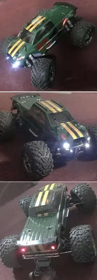

Made a shell from a stock E Maxx body for a friend of mine, and rigged up a solid mounting on the rig for the camera. The body has the grille cut out so the camera can see . I made it by mounting the camera, placing the bodywork on top, then, mirroring the camera's view through a PC monitor, cut out enough bumper/grille so that it would have an uninhibited sight. It was for a friend of mine, but I did photograph the body, which I also added head and tail lites and painted for him. Nice and clean.

The camera shoots through the open grille on my buddy's E Maxx. The pipes light up when accelerating too.View attachment 122467
What camera does it use? I was thinking of trying a cheaper/lighter camera, like an FPV camera, so it had less weight to it for inertia when jumping.
