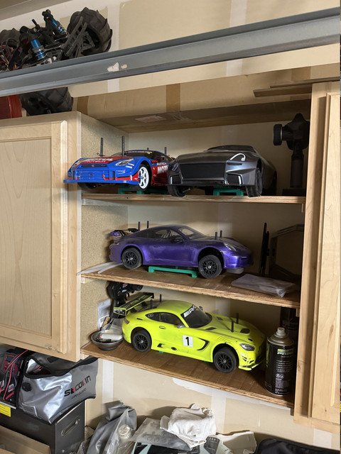

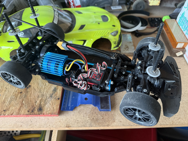

3 - TT02’s and a Redcat Rds.
The tt02’s have a 17t brushed and can power slide comfortably on out street at will, at your projected 15-20mph on 2s. My Rds I can now easily slow drift (now) in my gym. I believe what you are asking is reasonable and your 30 min is a good time to take a break. How are you practicing your drift?
privacy friendly list cleaner
That's fantastic.
Can you give me more information on that TT02 setup regarding tyres, diff or anything else critical?
Don't suppose could upload a video on street so I can see what they're capable of?
Practicing drift at the moment is setting up two safety cones at various distances apart.
Sometimes just doing circles around one, and then a figure 8
Pretty standard again with the TT02’s, they have been upgraded all the same.
CVA Mini shocks, aluminium propeller, motor mount, ball bearings, other than that they are all stock. Biggest part is the 17t motor is to break the tires loose. I was able to do it with the super stock but I wanted a bit more speed on the top end, I live on a corner lot with an empty park behind us so I have room to go fast. I couldn’t tell you how many battery packs we have gone through. We (son, my self, occasionally my wife) drive something or multiple daily so there is lots of time to practice. I’ve never really taken or uploaded any videos or anything. I have been doing this for almost 40 years though.
