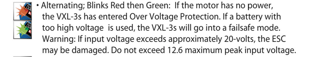

ok i found this its weird because traxxas lipos and chargers shouldn’t over charge i will test the voltage when i get back soon but how can i discharge it?
A fully charged LiPo is 4.2V per cell so a 3S lipo thats fully charged will be 12.6V.
Storage Voltage is 3.8V/C or 11.4V.
Nominal Voltage is 3.7V/C or 11.1V for a 3S LiPo.
I suspect your ESC was damaged and that had nothing to do with the battery.
