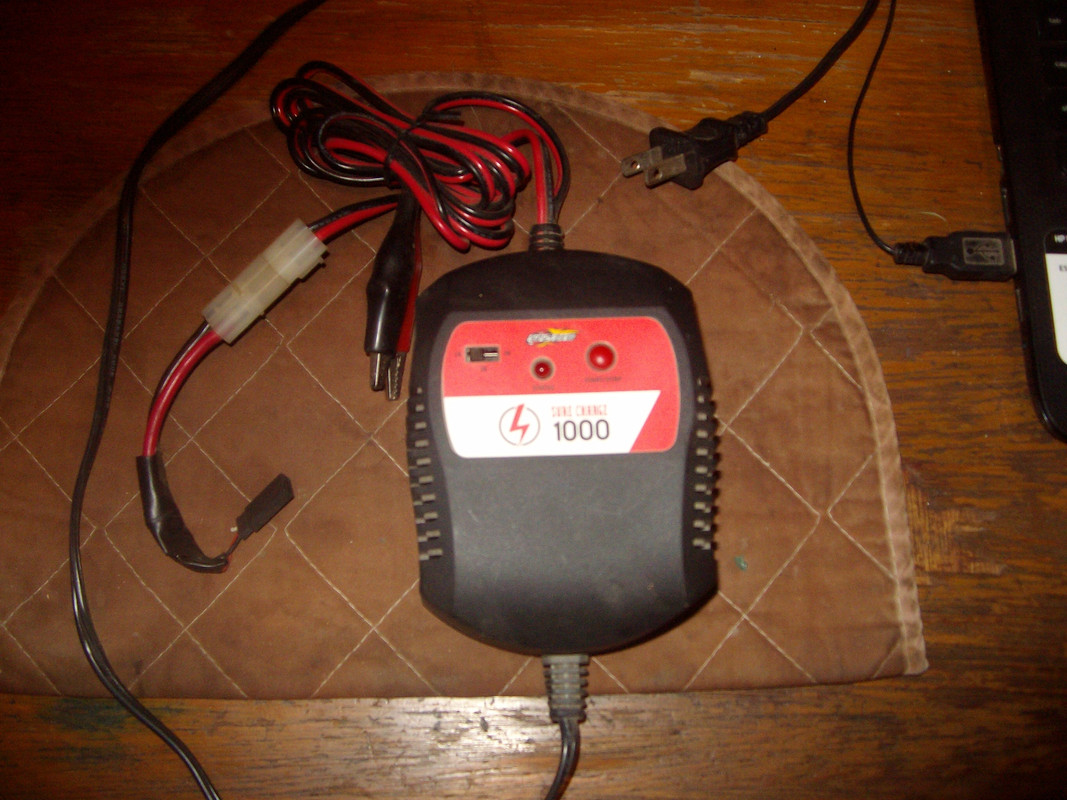

I use a Dynamite charger that detects a full charge an automaticly shuts off ,all you have to do is find a plug to match
your battery ,I usually make my own!
This is my charger ,I think that I payed 20 bucks for it used about 8 years ago ,I use it for rec. packs & c size batts!
