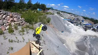

This project could not been done without Graham J's help, thank you buddy 🥰. Now i know exactly what kind of car "it used to be"..one of the reason i never got one back in the days..but after seeing the 2.0, yepp. Ohh, so you know, i do have a few ARRMA exbs, Traxxas, Losis, Xray and SWORKZ.
First of all, diff and shock oil setup is changed
10k rear - 200k mid and 80k front.
900cst on all corners
Maximum caster
Rear alu brace
Max8, max punch 37.5% brake
Leopard Brushless 4275/2000kv v2
17T pinion
Futaba Radio
Paint by Gabereal_rc

Dude that is a LOOONG WAY DOWN! Never get nervous just send it. So sick man hell yeah send it till it breaks. Then fix it and see if you can beat the last jump. Looks like a awesome stone query to bash in nicely down bud..
By the way congratulations!!! on getting you revo man. That's awesome!!!. I got the mini and man I love that little guy. Super fast for a 1/16th and takes a beating also

that poop made my stomach drop I could never jump my trucks like that
Oh it's not that bad... his in a pit you never saw his videos? Of that.. wish I had a pit by me.. would be so fun.. the X takes jumps all day.. that's why I love it... and I don't put aluminum upgrades on it...
yeah my dad ran a rock quarry for almost 20 years, I've seen some good pits lol I just don't bash my vehicles.
