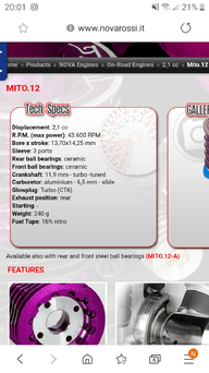

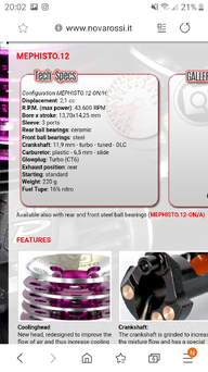

What do you guy's think about these novarossi engines? Would they give enough power to entertain me? And thanks already for all the answers.

@johnnydmd is going through the process of breaking one in recently for a drag car he is doing, I have heard nothing but good things about it, Novarossi is also a very good brand, one of the best up there O.S., I will say both engines are at different ends of the spectrum, the nova is a fast high revving, power band in the top end engine, lots of power in as small a package as you can get.
The o.s.TM is a pretty much a big block that is drop in to a small block mount. Lots of low end torque and good mid and top end. With either I dont think you could go wrong, but its about the equivelant of a twin turbo 4 cyl vs a built v8.
I've been running a 21Tm in one of my revo's for a few years. Probably only have 3-4 gallons through it, but it's a very good engine. Not sure it warrants the $300 price tag though. It's a niche engine as it's designed for a specific purpose and there aren't many options like it for the t-maxx/revo crowd, so the price likely reflects some of that as well as the quality/performance of it.
More torque than the TRX3.3 and once broken in, holds a tune all day long. Took over a gallon before it settled in well. I was very easy on it through heat cycle break in for the first 1/2 gallon, then continued to be pretty easy on it (not a lot of WOT long pulls) until about 1.5 gallons, which was around when the tune stabilized (didn't require fiddling much after initial setting for the current weather).
It has a more normal exhaust port on it, so a standard 1/10th header fits it unlike the TRX engines. The revo version has an odd arm on the slide carb to suit the revo's linkage. The t-maxx version I think has a ball end arm on it... both may come with both though, can't recall what was in the box. The other difference is the included header. The Maxx version's header differs from the revo, so they sell two different ones with the appropriate header included.
I'm using a THS revo high torque small block pipe on mine. I have the THS revo big block pipe on my second revo which has an LRP28 in it.

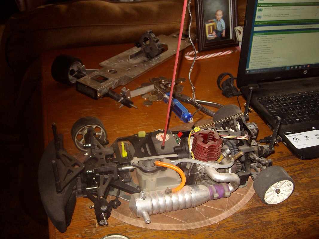

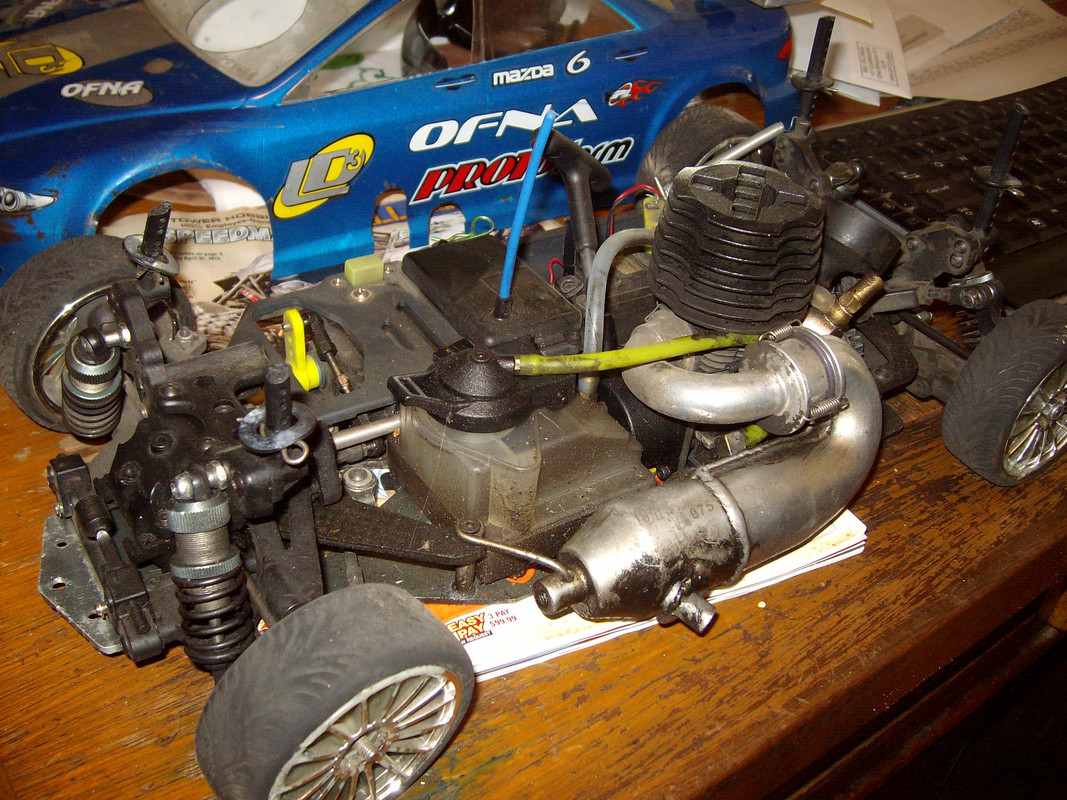

I have the 12 ,which came stock in the RTR Ofna Ld3 cars ,it pushed the car pretty fast ,with out making one nervous!
This is the one with the 12.
I also have the Ofna Force 18
an this is it ,it needs to be put back in another street car that I have!
What size Force engine did you go with?
