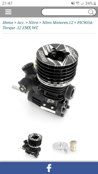

What do you think about the os 18cvr? Normally that was the engine that i wanted to order.
What about this one? Any toughts?
first qestion:
O.S. .18 CVR - Great engine, good performance, long life span (even with me being brand new to nitro and not having any clue how to tune), harder to find nowadays though.
second engine - i dont have any experience with that engine itself, that is a .12, so definitely a smaller engine, but it looks to be a good one, looks to be a race engine at that. it is a picco (also a great company), that is a slide carb, so like said above, slight modification may be necessary.
You can find them ,but they run up to almost $ 200 bucks ,that engine was a perfect match for those street cars & 1/10
stadium trucks an were very popular to have in the day ,I have one on my AE.10 stadium truck .an it has extreme power!...:p
