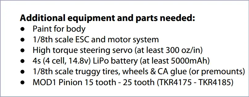

Well, in the front of the ET48 2.0 manual its states that a 15T~25T pinion gear is needed.

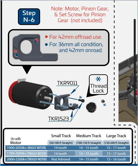

In the assembly part of the manual, it suggests a 14T pinion gear to be used in certain cases.
Will a 14T pinion gear fit? Is it the smallest pinion gear that will fit?
According to my setup sheet for my EB48 2.0, I'm running a 12T pinion. The motor mounts and spur gears, on the EB48 2.0 & ET48 2.0, are the same. I'm just trying to figure out my options as I track down the right powerplant for this ride.
This is the motor guide for the et48 2.2. I just ordered a 2000kv, planning on starting with a 15p.
Yeah, as far as tires/motor go, I'm not quite sure on the configuration I'll go with yet... monster-ish truggy with heavier wheels, or normal truggy. There is also an idea tossed around my head of going with a larger spur gear. In any case, that gearing chart is about the same as what's in the 2.0's manual.
Thanks for the picture of the paper manual! The online revision 3 of the ET48 2.2 manual is definitely different. I wasn't sure a 13T pinion gear would fit, but it will indeed fit.
My EB48 is running a 14T pinion gear with its 42mm can onboard at the moment. My initial 4068 size motor allowed me to us a 12T pinion and I never updated my setup sheet notes :facepalm:
Anyway, a 13T pinion is the absolute lowest tooth count a person can go with using 42xx size motor on the ET48 2.0
