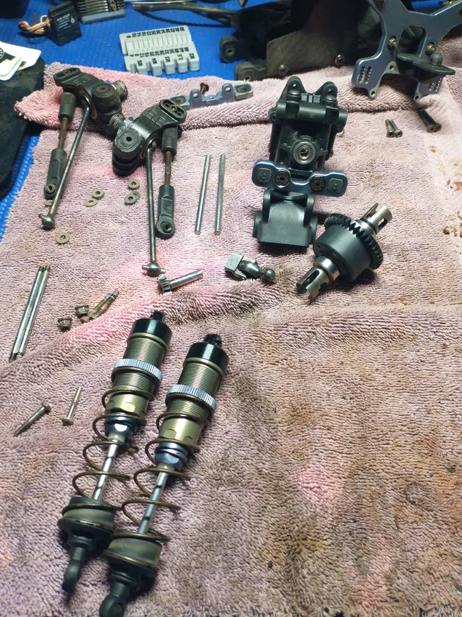

Back, Back Together

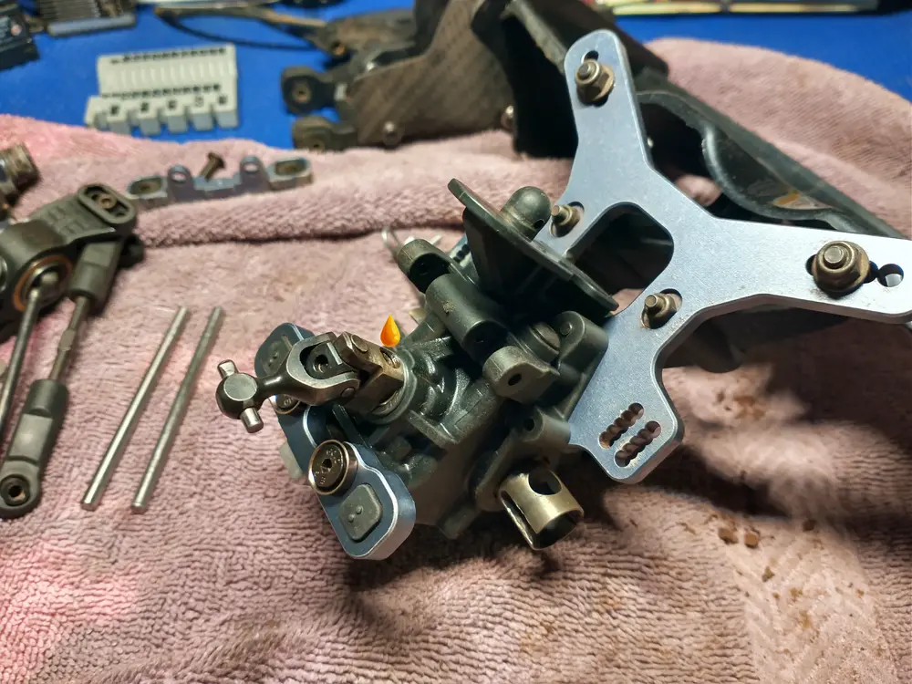

Orange threadlocker on the uni driveshaft's set screw.

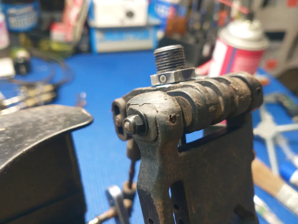

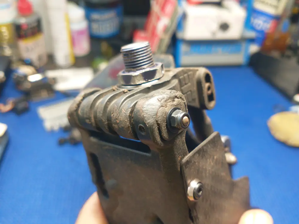

Yep, I can see new arms needed for next year. Pebbles being the culprit would be my guess as to the wear at the outer hinge pin area. I added a washer, before the locknut, at each end of the hinge pin.
