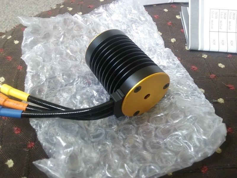

Now, on the T4.2FT, I run a Duratrax 17.5T, and that motor is a BEAST. I tried to find another one @ the same good price I paid for current DTX 17.5T motor, but everywhere I look they are about $70. Not happening.
