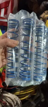

Another note got new shock springs for the maxx they are just ridiculous in size comparison to the 1/10 spring 🤣🤣🤣🤣

LOL, Those springs are pretty dang big :)
