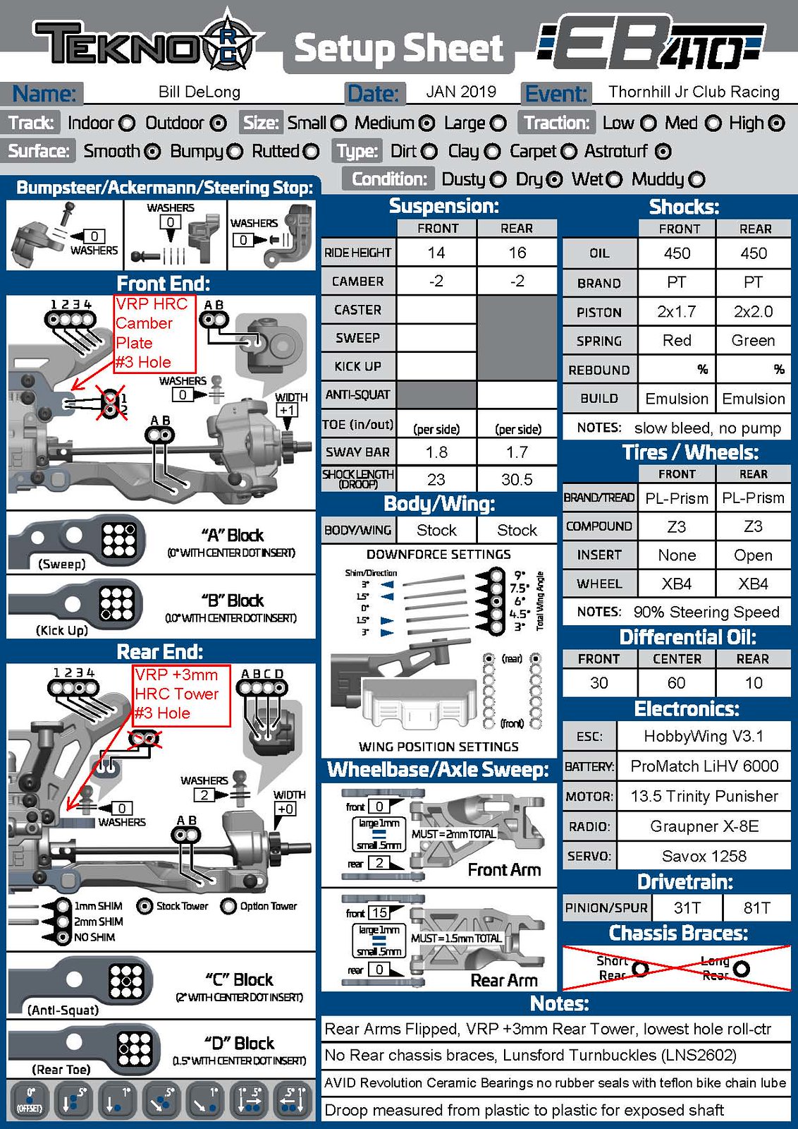

Hi Bill. I think I saw somewhere you had tekno eb410. What setup do you recommend for carpet in terms of diff and shock oil. My tekno buggy was set for clay by the previous owner, I didn't change much except 45w shock oil front and rear, but I will go a little lighter rear, like 42.5. do you run toe in or out?
Last race I didn't have a lot of traction up front, but I think tires are worn out. Do you have any other suggestions? I run et410.2, I bought it couple months ago and it was set pretty good for carpet, eb410 I bought 4 years ago but I was not racing since 2019 and started couple months ago again
Good News is that your track is very tight and technical... the EB410 was not designed for high grip carpet and won't be as competitive with high speed corners compared to most modern brands which typically offer a dirt or carpet edition, I worked with several team drivers to include Joe Bornhorst and Ryan Lutz who came to offer a race clinic where they both wrenched on my car to get it dialed in and here's a clip of Ryan test driving my car:
Here's the best setup I could get out my EB410 on turf:
https://www.rcgroups.com/forums/showthread.php?3003521-BUILD-REVIEW-Tekno-EB410-1
I would later switch over to PR Racing and it was like taking a knife to a gun fight, I went from on the bubble to get bumps into the A main with TEKNO to becoming a pack leader consistently on the podium with PR. That said TEKNO is a beast on dirt!
Note that 30-60-10 was necessary to tame the beast on turf
I currently run 10-60-5 in my PR where it can handle a far more aggressive setup without risk of traction rolling ;)
https://www.rcgroups.com/forums/showthread.php?3268789-REVIEW-PR-Racing-SB401-TypeR
Note that my Clay setup for SDRC works extremely well for Thornhill's Turf track too!
