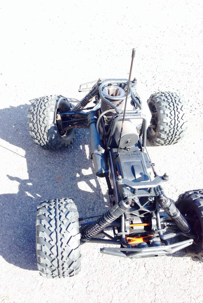

So.. Went out today to give the puppy another spin. Lost one of the long pins that holds the axles. The rear right one.
Phoned my RC dealer and he is like, "hihihi..Yea that happens, come stop by and I'll give you a new one."
Got there and he gave me one. He asked how is going otherwise. I told him the issue I'm facing. He said no probs, bring the car in and he will have a look. He then tuned it for me and he adjusted the gear ratio. Finally, my second gear kicks in and this beast is faster than ever. He really took his time and showed every step he did so I could follow.
Anyhow, as he raced it up and down the road, the throttle/brake servo gave in. Luckily while in low rpms :D. He is like, yea, these stock servers and nodded his head. He replaced it with a HPI SF-1.
Went home and took it for spin on a farm. We stay very close to one. So much fun, she just screams for action. 3/4 tank down the line, car won't steer anymore :(. Servo NO 2 that went.
Back to shop.. He then replaced it with a Towerpro MG996R.
What a day. Can't wait to take her out again :D
Are those servers any good? He replaced them free of charge ;)
Just a pic of when I lost the pin.
Sent from my iPhone using Tapatalk 2
