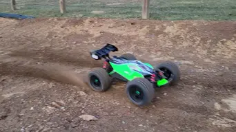

Typhon V5 BLX 6s – “Green Machine”
Won this Typhon through an Arrma Forum Raffle. Already had a "street" Typhon so decided to make this one a Basher.
General RC Information
Motor: (Stock) Spektrum Firma 4074/2050kv
ESC: (Stock) Spektrum Firma 150A
Receiver: Radio Link – R6FG
Servo: DS3235 Pro Servo
Current Diff Fluids: 60/500/30
Current Shock Fluid: 550cst
Current Gearing: 50/14
Current Tires: dBoots Backflip-LP Tires
  • Aluminum Servo Arm
  • Aluminum Servo Mount
  • Hot Racing Aluminum Motor Fan Mount
  • 2x Surpass Rocket 40mm Motor Fans
  • M2C F/R Center Drive Shafts
  • M2C F/R Center Chassis Braces
  • Replaced Motor Mount Screws with 3mm Flange Socket Head Screws from McMasters-Carr
  • Fast Eddy Bearings
  • Hot Racing F/R Aluminum Gear Box Case
  • Hot Racing F/R Center Sway Bar Mount
  • Arrma Metal Center Diff Case
  • GPM Aluminum Center Diff Mount
  • Neon Green 3DRC Wing Mounts
  • Notorious 6s F/R Body Posts
  • Notorious 6s Center Roll Hoop
  • Arrma Rear Metal Skid Plate
  • Arrma Super Basher Front Bumper
  • Arrma Rear Mud Guards
  • Hobby Park 17mm Hex Extenders
  • Kraton F/R Stub Axles
  • Kraton F/R Hubs
  • Kraton F/R Spiral Cut Diffs and Input Gear
  • Kraton Rear Shock Springs
  • Raised Droop
  • 2x 3D-RC Fan Covers
  • Green Typhon Mega Body
  • Green Headlights and body lights
  • 3DRC Neon Green Bumper Guard
