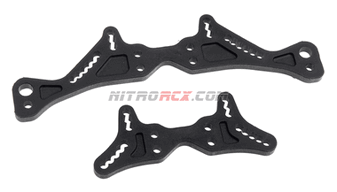

I did run into a bit of an issue with that shock tower. Although i found it listed, noone seems to have the plastic, aluminum or carbon fiber one in stock, and, oddly, i can't find a part number listed anywhere for any of them. I emailed ZD Racing to see if i can get the manual from them. Another thing i found out is the 10426 and the Pirates 3 TC-10 are the same car, just different chassis numbers and bodies. The Pirates 3 is a mostly aluminum chassis, and the 10426 is a mostly plastic chassis. They are also listed under the ZD Racing Thunder 9108 name, but so far no luck finding parts under that name. So far, the only thing i have found is a complete Pirates 3 mostly aluminum chassis, for around $150, which is making the HSP 94123 chassis i found seem better and better every minute, since i know that for that chassis, there are parts available almost everywhere, from eBay, Redcat Racing, Amazon, AliExpress, and BangGood to name a few. I can't really get to any of my cars right now, since i am in the middle of remodeling, but, once i can, i will see if the Exceed RC Mad Speed shock tower will work on that car. If ou can hold off a few days, i can dig my cars out and compare the two shock towers. The two pics are of the plastic and carbon fiber shock towers for the Exceed RC Mad Speed, but they are currently out of stock.

Dude you're the numero uno for sourcing parts those all look like they would fi ??
Sorry i havent gotten back to this sooner. Ever since the weather broke, i have been extremely busy. While i havent verified if the Pirates 3 parts will work, i can verify that the Exceed RC Mad Speed parts will work on the 10426, at least, the shock tower you need.
