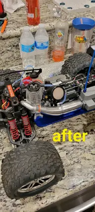

Installed ths pipe and motor saver filter on the tmaxx 2.5. She woke up a bit and of course I had to do a little fine tuning. Anyway I roasted 2 glow plugs in like 20 minutes 🤣 so I ordered 3 LC3 O.S. glow plugs and we're going to see what happens. What are your thoughts on this. Guess I gotta richen her up quite a bit more than I thought maybe..

I have a ths pipe on it with the rubber 3 spring cupler that has me thinking
