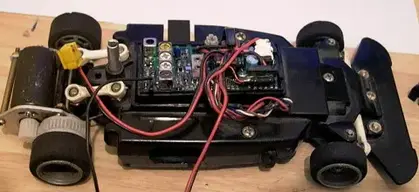

Here's a prime example, I bought an old (12 year+) Tamiya TamTech 1/24 scale GTP car with the ESC/RX combo called the CPR.
This thing was trashed, who ever owned it before me sure got their money's worth out of it.
Diff was worn, wouldn't turn, the built-in receiver was out of synch, someone had adjusted the oscillators and the tires were worn, the rims trashed, as in hairline cracks..
Chassis was badly scratched as was the motor from outside use. The motor was pretty tired too...
The bushings were worn thru too...
Here's a before pic
