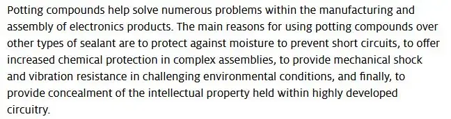

Additionally as you can see in the screenshot of the Savox's servos specs, its Waterproof. Pro-modeler says nothing about their servo being water proof.
Lets explore this statement on Pro-modelers website.
Pro-modeler brags about their bearing being 25% bigger but looks to me like its really only 25% taller. Not sure how much that really means in the over all scheme of things. maybe someone that has technical knowledge of bearings can chime in as to how much difference that would make in real world applications but we can explore other aspects of this statement.
On top of the bearing being "bigger" they claim their bearing is shielded and ABEC-9 rated. Lets pick that apart for minute. The bearing is in a closed environment that is filled with grease. Does it matter that their bearing is shielded? I'm not a bearing engineer but my gut says "no, it doesn't". In fact wouldnt a shielded bearing actually be more prone to retaining heat than an unshielded one? Again not a bearing engineer but the thought pops into my head giving me cause to wonder.
Ok now on to ABEC ratings... Heres a screen capture from Wikipedia
Ok, So its true that Savox doesn't give us the ABEC rating on their bearing but would it matter if they did? According to the screen capture an ABEC5/ABEC7 bearing could be as good or better than an ABEC9 depending on the other critical factors that arent taken in to account in the ABEC rating scale. Plus we havent ruled out the possibility that Savoxs bearing may also be ABEC9 anyway.
Now one truth that I can see Pro-modeler saying about their comparison against Savox is that their gears are "beefier". Again though what they dont tell you is that Savox sells replacement gear and bearing sets. I dont see that offering on Pro-Modelers website.
So in conclusion, after you peel back all of Pro-modelers marketing bullsh*t. I dont even trust that they are truthful about their servo specs. Who knows what kind of shadiness may have went on during their servo testing where they generated those specs from in the first place. Hell at this point even if their specs were true and they were the ones who are $10 cheaper I still wouldnt buy their product just on principle but you guys can judge that for yourselves. This is just the rabbit hole I ended up exploring once I started seeing inconsistencies in what I was seeing and reading.

Now the one (and damn near only) truth that I can see Pro-modeler spewing about their comparison against Savox is that their gears are "beefier". Again though what they dont tell you is that Savox sells replacement gear and bearing sets. I dont see that offering on Pro-Modelers website.
