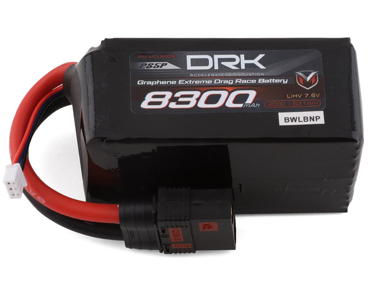

Not a drag racer, but I've seen 2S become the standard as other's mentioned. The quality of the battery matters a lot for high current applications (like drag racing). There are special drag packs that have a parallel configuration. If your serious about it you might want to look into some high end batteries at some point.
They are very expensive. This one (probably overkill at the moment) is 2S5P configuration. Meaning it's 2S voltage and 5 cells in parallel. Parallel configuration means massive amounts of current.
https://www.amainhobbies.com/maclan...0c-lipo-battery-7.6v-8300mah-mcl6024/p1395798
