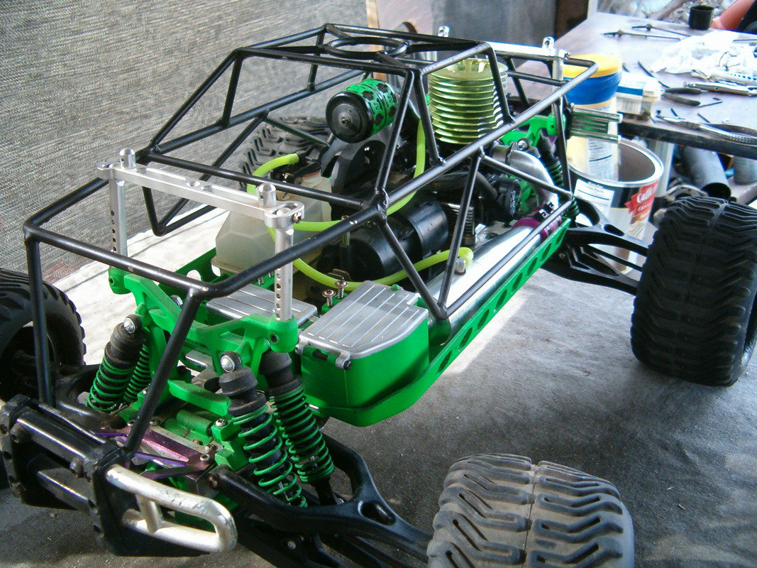

New to me Associated MGT .21R Revival
Its looking great ,you wont be disappointed with durability of the truck ,however ,probably
not the fastest with that engine ,the engines are reliable an easy to tune ,an those trucks
are tough!
Keep up the good work!...:thumbs-up:

I used the fluoresnce green on my trucks with a clear coat on top of it ,the clear coat knocked some
of the brightness off of it!
really like that, are those the RC Raven dual rates as well? or are those another shock?
think i might do more or less green accents, plan on doing a black lid for it with green accents. i like the cut-outs in the black mud guards.
lol was on ebay and saw this: https://www.ebay.com/itm/Hardcore-R...umper-Mount-Associated-HCR-13212/232953169867
i like the purple touch though
My springs are painted ,but later ,I will eventually get something else.
That HC bumper brace is nice ,but you would have to find the mate ,those parts are getting scarce ,so any time
you do find them ,snatch them up!
I had a chance one time to get the front an rear green HC body post ,but some a$$ hole snatched one
out from underneath me ,the seller was selling them separate!.....:doh::doh::doh:
