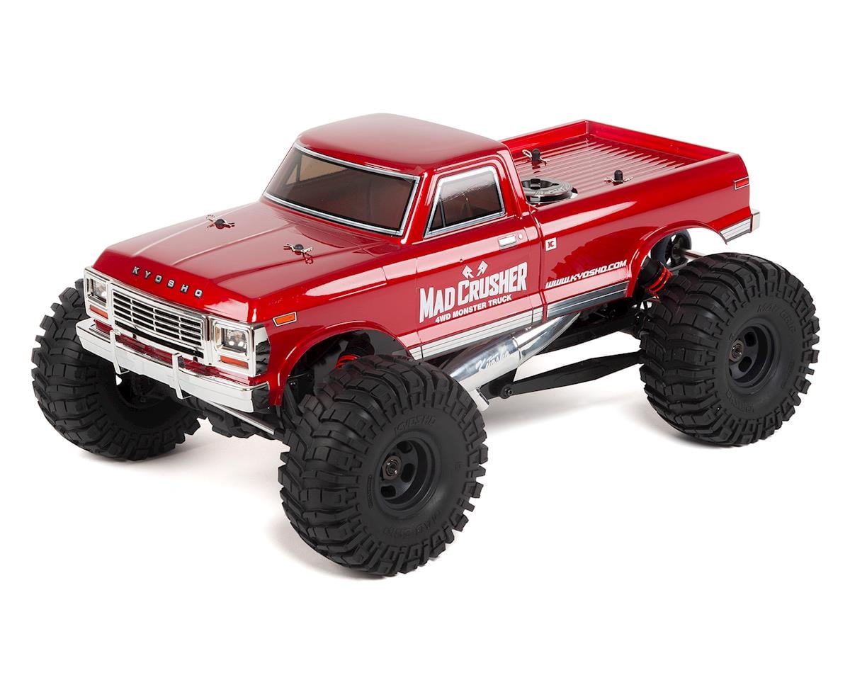

Yes I am quite happy with it now. It was $469. But If they had any Kyosho Nitro Mad crushers they are listed for $439 with a 3 speed and solid axles.
Hey now, I really like the way this dude looks! Not sure how I feel about working on a 3 speed transmission though but she definitely looks awesome :)
That is a stretched FO-XX. Same engine and transmission. The only thing wonky on mine is the steering and they are supposed to have fixed that.
It should be a really fun basher.
I was looking at that Mad Crusher the other night by Kyosho. In fact I’m impressed with Kyosho as a brand so far. Seems like that old school Japanese qaulity is still alive.
I have a Neo Inferno truggy and an FO-XX. Not the fastest but easy to start, always work, don't break and great fun. Everything you want in a basher.
You can get parts at Kyosho, at least you could before civilization melted.
