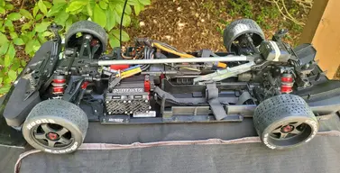

My Arrma Infraction 6s is really stock, but I have done some upgrades & built the diffs & added dual fans.
50k/200k/20k F/C/R diffs & Arrma aluminum front center diff mount & I milled 1mm off the top of the composite center diff cover for better wire clearance. Added heat shrink wrap to the motor wires.
Scorched RC Titanium Ti5 top steering plate.
YZX aluminum chassis braces-made in USA.
Surpass Rocket dual 40mm fans mounted on a HyperFlow 3d printed mount & CF cover. Scorched RC titanium splitter screws. Powerhobby titanium chassis skids. 3d printed TPU SkyRC GNSS mount. 3d printed FPV camera mount on rollbars for future use. gensacearespammers 6800mah 120c dual 3s batteries. I took the stock rear wing & trimmed it into a aero shade & painted it 3 colors. The red is translucent red. Holes added across the rear upper wing. More upgrades on the way. I will update as they arrive & get them installed.
