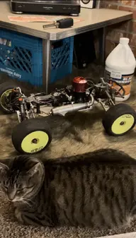

Going to start a thread to keep track of my first build after almost a decade of not having any RC cars. I bought this chassis for $60, came with a completely smoked HPI 4.6 so I decided to get a Dynamite Big Red .28 for some added hp. Just got my Dynamite mid range pipe in the mail, and waiting on my fancy Big Red adjustable clutch from my local hobby shop. Anyone here ever put this engine in their HPI or HB truggy? I’m sure I’ll have many questions along the way while I figure out the little nuances of making this mix of parts work together.
First question, what aftermarket parts are still out there for these? I do understand that many are discontinued, mine is the pro HB version with the beefed up suspension, but sometimes cool shiny stuff is cool to have just because. Who out here runs one of these rigs, and any suggestions on mods?
Second question, I have the HPI body though I prefer the Hot Bodies style one, aside from the owner before me doing an awful paint job. I like the old school stadium truck look, though I’m open to other cool 1/8 truck bodies. Anyone know where to get 1/8 scale body shells that look like the stadium trucks of the good ol’ days?
Third question, what flywheels have people used with this engine? I have the stock one but would like to have all new parts while I’m in there.

Made a slight amount of progress and test fitted my engine mounts and mounting plates to fit the big red. It’s a bit beefier on the very sides of the crank case and had to grind the insides where the mounts bolt up to the engine down a bit, and the purple mounting plates needed a notch put on either side of of the back end to gain the ability of full side to side adjustment and clear the mounting flange for the pull start. They also had to be spaced up with washers to clear the ribs and gussets on the bottom of the crank case, this will be all cleaned up and made pretty when finished. Hopefully this helps anyone swapping in a big red whether it’s a hot bodies or HPI like mine or any other brand in general.

Never owned a rig with any dynamite equipment, I’ve heard only good things, hopefully in combination with my 15t dynamite clutch I ordered and the mid range pipe it has some good top end. Hoping for around 50mph but we’ll see, and that having a bit taller gearing and the 4wd helps keep wheelies under control but still able to get those wheels off the ground when wanted
