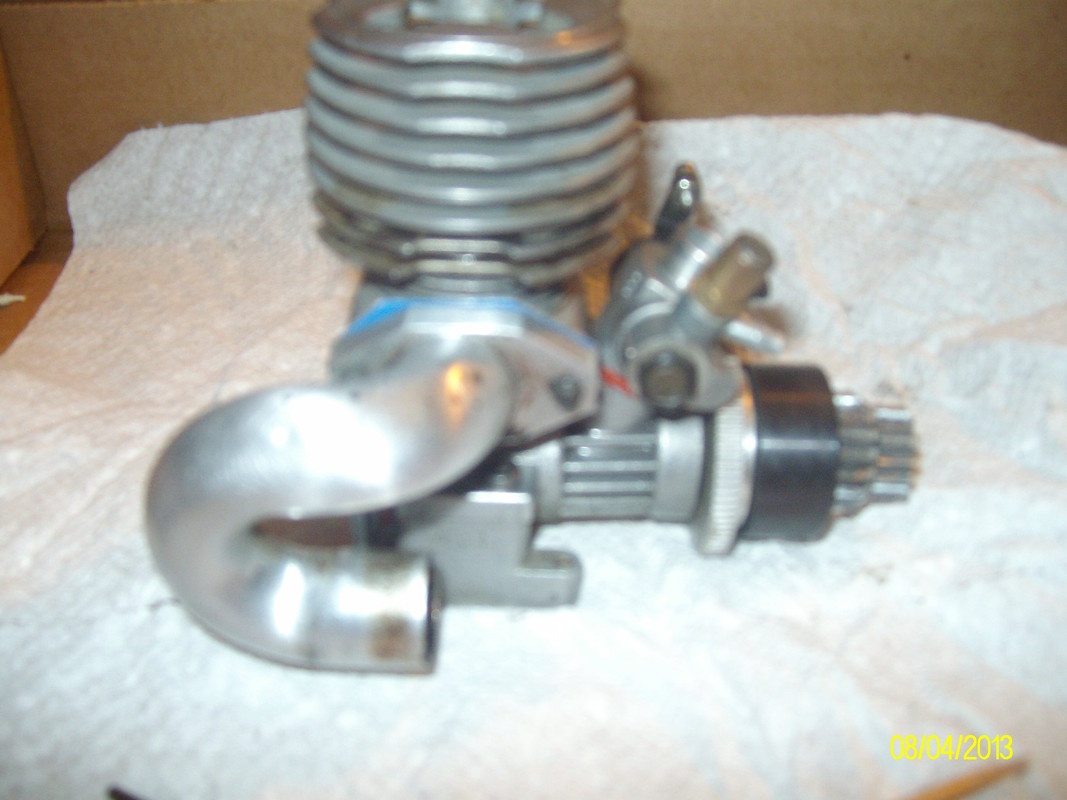

Well I'm a total newbie to these things, I spend most of my days playing PC games, Picking out banjo tunes or watching the cartoons of me childhood. Here is the actual engine. It's just listed as Force Engine. 15 CNC. By the way. I love the rims on that car.
Well I'm a total newbie to these things, I spend most of my days playing PC games, Picking out banjo tunes or watching the cartoons of me childhood. Here is the actual engine. It's just listed as Force Engine. 15 CNC. By the way. I love the rims on that car. View attachment 121923View attachment 121922
That is a nice engine ,I think that most brand headers do fit from 12 to 18 size small block engines with
the screw on headers!
But like I said ,it also depends on what it will be going into because of the bend of the header ,that is where
your problem is going to be ,unless you are going to put it on an engine test stand to run it!
It is also important that it has a muffler for the pressure tube that goes to the fuel tank to push the fuel
to the carb.!
I have the Ofna Force 12 & 18 engines ,but my 18 is a rear port an takes a spring mount type!
But here is my AE. 18 that has a screw on side mount header!
