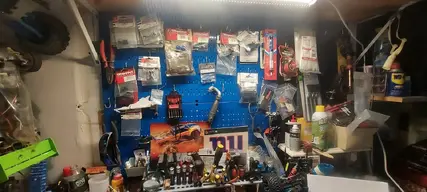

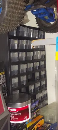

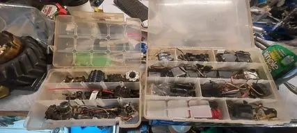

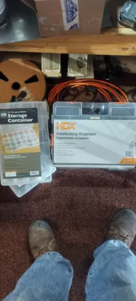

How do you sort and store them?
Whith all the hardware and electrical items and small parts and what not. I just use storage organizers. Which I usually pick up from harbor freight. Got one for screws and hardware. One for soldering/ connectors, wire, heartstrings. And others for nitro engine parts. And others for servos recivers/electronics. Also a big fan of the pegboard..still need to put up the other two blue ones I got the other day...
