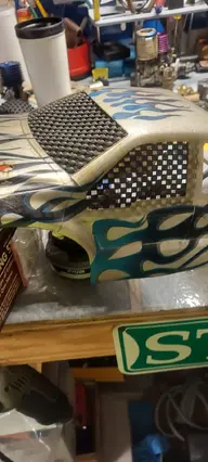

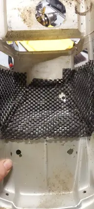

I actually use the screen on my windows instead of cutting/drilling holes in my bodies. Oh 💩 just remembered can also use shelf liner also if you don't have any screen laying around.. again cut a strip and glue to the bottom body.i also use it on my windows for air flow...

Sounds good. Yeah there's alkt of different ways to go about it. You could also make inner tire wells. To keep crap out... with some thin plastic pieces. You can heat them up and put a 90° angle on one side for mounting.. I can think up a few ideas. Need help post up idea or a thought youbhave we will help you out no worries man. More then one way to skin a animal
Just a heads up, the shelf liner that @StonerRC365 is recommending is cool stuff, but does have a chemical reaction to some plastics. In this case it will most likely not be an issue. But if you leave it in contact with other plastic items laying around it can melt them. When not in use make sure to wrap your extra shelf liner for protection.
