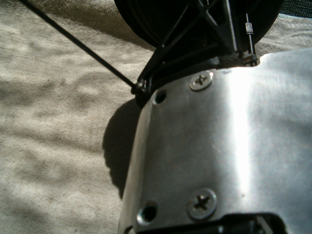

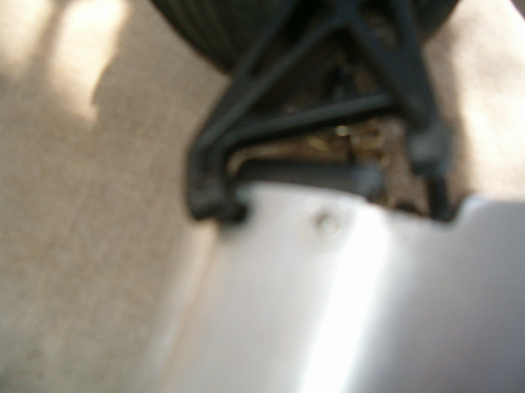

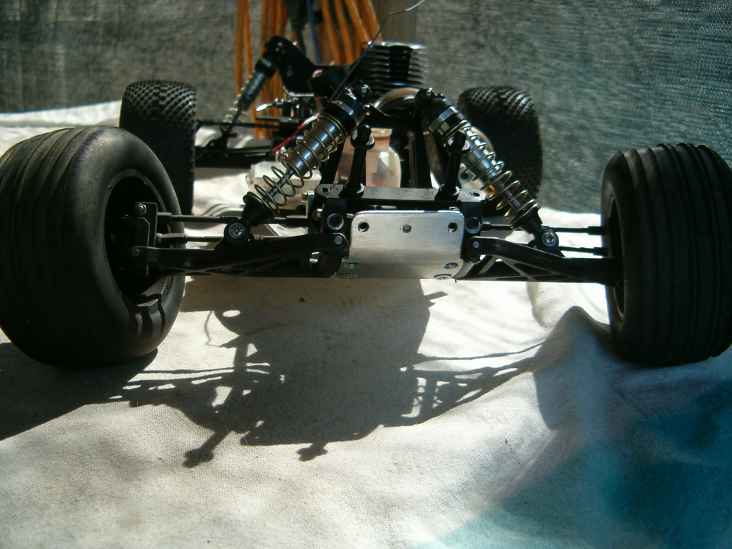

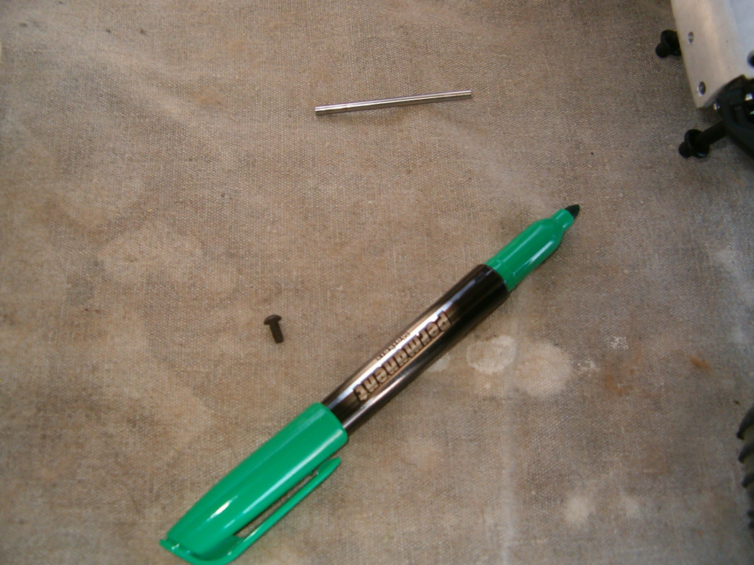

I got this going today ,I had glow igniter problems ,it ran great ,but lost a front hinge pin ,I will have to make one ,
an I think that I will modify for a captured set screw with putting a flat spot on the pin!
Try to get a running vid today or tomorrow!...:cool:

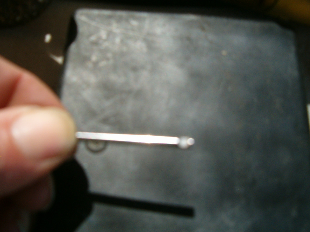

Ok ,fixed the pin by drilling a hole in the a-arm for a set screw ,then ground a little spot on the hinge pin ,
so now it is good to go on a Go=pro!.....:celebrate:

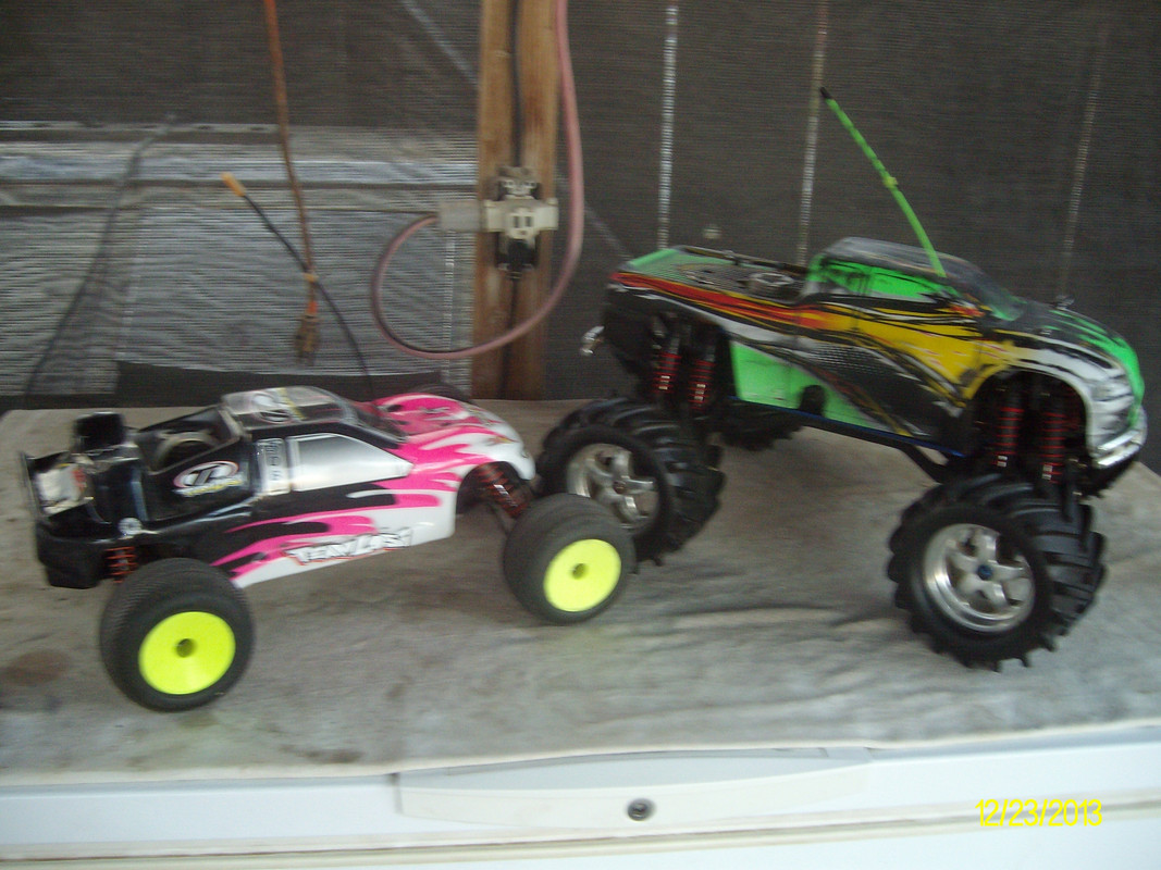

Here is the 2 that I fixed !
You can fix one of those duratrax up as a nitro street car ,that would be cool ,if I had one ,that's probably
what I would do ,as I don't run those little guy's as bashers out in the field!
