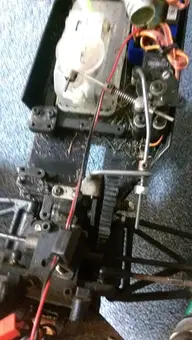

i have (from what i was told) a old RC10gt. it was a gift from a friend many years ago and I'm just getting into it now. the other day i had it running and all of a sudden would not accelerate anymore. what i saw was the spur gear stopped and the bell housing not moving when i tried to make it accelerate and also a clacking noise on the initial push to accelerate. my first thought was the clutch was bad so i took it apart and attached the picture of what i found EXACTLY as i found it. there were no springs and its boggling my mind to how this thing is supposed to work because the top of the shoes and the inside edge of the bell housing are SMOOTH.
does it look like i need a new clutch? bell housing? has anyone ever heard of a clutch with no springs on a nitro car?
btw i know my spur gear is FRIED and will be getting a new one and aligning it properly.
i forgot to add that when i pull the starter the motor turns over and the flywheel moves and is not free of the shaft.
How do the clutch springs look? I would try sanding inside the bell and maybe replacing shoes and springs.
when i opened it up there were no clutch springs....why would someone cut the shoes down? i thought they looked really small but wasn't sure if it was suposed to be like that.
I have an old gt also. I haavent got it running yet so I will share with you what I have read. First, I know that there are not any springs in the stock clutch. It is working on centrifugal(pretty sure that's accurate) force. The stock shoes were known to have slipping issues, esp with high power engines. However, they weren't terrible either. It was common practice to put the shoes in 'backwards' to increase the bite as well as trimming them back to adjust where, when and how they bite. There is info out there avail regarding all of this, however I don't have a link for you. By the looks of it, you may be due to replace the shoes. I have also heard it recommended that you should take some emerg cloth to the bell to rough the surface up a bit. Also, if the bearings were lined recently, that oil will spread all over the surfaces in there which will cause all sorts of unwanted slipping.
In your situation, I would read up on the shoes and how to trim them to get the desired operation. I would be sure to rough up the bell a bit and clean everything up nice... Your pics show there is a lot of dirt in there, oil or not. Also keep in mind that you could cut the shoes just to test out the operation, even if you cut past the desired operation... Strictly to test. There are metal shoes available to replace the stock Teflon. I have heard good things but again, no personal experience. Then again, you could always step up the whole assembly with a nice 3 or 4 shoe set up. There are a number available out there. Wish I had more for you and please, post about what you do and how it works... I could use the experience too. Good luck!!!

good to know! i did actually check the bearings and the bell spins nice and smooth. i actually got mine in a trade for fixing someones paintball gun a while ago (i just had to adjust the velocity haha) because he couldnt get it to work. now with a new carburetor, tires, starter (i burned the old ones out) and some fuel this thing wheelies when i accelerate from the power. it has a old hpi nitro star .15 in it and it looks like it was barely run if at all when i got my hands on it. it didnt even have a body! everything else is original to my knowledge and it works just fine, the idea for me is to just use it like it was supposed to be and replace with new/old stuff as they break. thats why i was kind of suprised when i saw those clutch shoes because they were a lot smaller than i thought they would be AND NO SPRINGS. honestly i dont know too much about the car or the sport, I'm just learning as things break or i have to clean them off but there is something about the noise and the look of this little loud mosquito running around that makes me smile ear to ear. it doesn't matter that their outdated, there CLASSICS!
Someone may have altered those to fit.Some shoes only have 1 big spring that goes around
all of them an hooks together at each end.
If you change a different style like 3 shoe set up ,you will also have to change the fly wheel
as well for a 3rd prong for 3 shoe ,or you might can find a original 2 shoe set up with spring
from MIP products....:cool:

For what it's worth, the clutch bell and flywheel look to be (I'm almost 100% sure) stock. The stock set up does not use a spring for sure. If you go to associated and look in manuals for discontinued cars, you can d/l manuals, blown up pics etc... I believe you will find the info for the clutch shoe cutting, functions of that etc... In those manuals. I am not sure that it says anything about turning the shoes around. I believe the purpose there is just to make them grab better so again, it's gonna be a matter of testing and personal preference. The 2 shoe is a setup for the pullstart. There is a 4 shoe avail from associated for a non pullstart. They are Def different flywheels. Aside from the 4 pins, they are raised (or the outer edge is cut down) I don't know why the 4 shoe doesn't work with the pull. I am also not sure how it would be effected by the output (crank shaft) modification that the gt needs on a LOT of engines. I don't know about you engines so I don't know if yours required the mod. Again, lots of read info and none used in practice.
Def would have to buy a whole assembly to put on a 3 or newer 4 shoe to include the flywheel. MIP is Def an option for a better 2 shoe. If you Can find an MIP 4 in 1 clutch, it's supposed to be a good option. At the time, they were cheap. No idea if they are avail and if so, what they would be price-wise vs some of the newer and likely stronger new units. You can always look for the aluminum shoes to drop on your factory set up too. There are plenty of options open to you.

I did a lil looking... I believe I got the pull start and jumpstart flywheel confused... The flat one, (yours) is the bump start style... So I think the 4 shoe with springs (they are little single spring per shoe style) SHOULD bolt right on to your car. Its all associated stuff so you should be in good shape.
thanks, i just ordered replacement shoes and a new spur gear. i want to get it working right again first and then possibly try converting it to the 4 shoe setup, as much as i want to keep it the way it was i am curious how much of a diffrence it would make with 4 shoes instead of two.
As I understand it, you'll have better ability to adjust and control when and how the clutch engages when you use a 4 shoe. A stronger, more reliable lock on the clutchbell.
