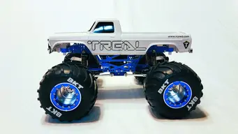

Chungus of Smashers
FMS Smasher with Mini LMT Tires
General RC Information
FMS Smasher
Furitek: Chassis, ESC, RX, Motor
Treal: Gears, Bead Lock Wheels, Long Stub Axles, Drive Shafts
RCAWD: Shocks, Suspension Links, Hex Adapters
NexxSpeed: Steering Links
Ramp Crab: Servos
Losi: Tires
3Flow9RC: Wheel Nuts
FastEddy Bearings
High Gear Lockout
4W Steer
Mini LMT Tires
Double Shocks/corner
RC Type
Truck
RC Brand
Other
RC Model
FMS
RC Scale
1/24 Scale
Technical Specifications
Power Source
Electric
Battery Type
LiPo
Motor Type
Brushless
Drive System
4WD (Four-Wheel Drive)
Additional Information
Budget
$800-999
Challenges Faced
This (like most of my builds) had a lot of trial and error. Getting the Losi tires to fit and to keep a good turning radius was probably the biggest challenge.
Another issue I face as always is that I "buy and try" parts instead of taking the time to do research to see if I can make it work. I sometimes end up with unused parts because of it but the extra parts I tell myself will come in handy later.😆
