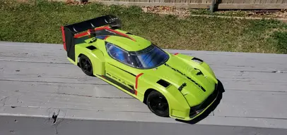

My Arrma Vendetta Project a mostly stock Vendetta with a few little upgrades.
Nice clean build. :cool:
Thanks so much, She's still a work in progress i kinda just threw her together with what i bought this month plus what i already had from my other vehicles. The motor i have in her i think is on it's last leg it's starting to overheat and it's not as powerful as a stock combo although it's a 3,200kv running a 19 tooth on 3s instead of the stock 3,900kv running a 20 tooth on 3s. On the other hand the Max 10 SCT esc runs perfect and cool but someday i plan to swap in a Max 10 G2 140a 4,000kv combo after that she should be a screamer.

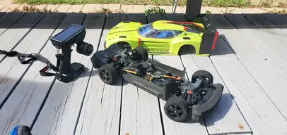

Hi everyone, How's it going? Here's a new update on this build after many months i have been busy sorting out this car problems from the diffs to the ESC going into LVC too early. I can say i've got the ESC sorted out i had to download the Spektrum Smartlink usb application for PC and get the Spektrum programmer V2. I updated both the programmer and the ESC i've also ordered diff parts mostly shims so i can get the front and rear diffs all shimmed up properly. i also ordered a new Spektrum SR6200A AVC receiver off eBay from a new rig to bind up to my DX6C since the last update i was running her on my old Radiolink RC8X with an R6FG receiver but i sold that radio almost 4 months ago and now run a Spektrum DX6C and i still have my Futaba 4PM on standby.
Here was the car before i took her all apart for the ESC update.
Here she was after i took her apart for the ESC update.
I will post another update and refresh the build showcase once i have the new parts in.
