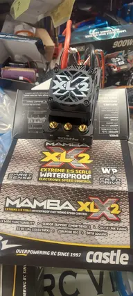

Man this 1100kv motor is huge. And it weighs a tons for a RC motor.. hahahaha Can't wait to install it into the Kra. But some upgrades need to happen first 😉🤔😁👍👍 the esc is beautiful piece of equipment for sure. The motor is bigger then a Tamiya paint can taller and wider my God POWER!!!

Gonna be a sweet ride bro. I agree, the 1100s are giant.
Rite I'm shocked how big and heavy it is
