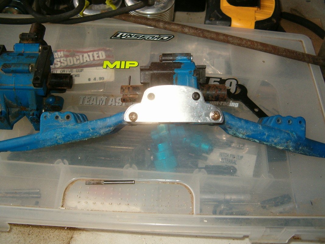

If you have some tin you could fab up a metal plate to span those two holes to strengthen that. Like this...
But that is a bad place to try to repair.
When you get the glue, try also using some plastic from a sprue or something to melt into those cracks and onto the surface. Maybe that will help.
Another idea is buy a sheet of styrene from the hobby shop. Cut it to the same shape and use the glue to laminate it onto that face.

That was what steered me away from trying to bash a buggy ,but my Mgt had similar problems ,but
i was able to make an aluminum plate to help re enforce it with longer hinge pins!
Nice fab work Baker. Well done

Thanx ,it was a little crooked in shape ,but it will do the job!..:cool:
Yeah thats still nice fab work bud 👍👍. Doesn't matter if crooked bud. Only matters if it works for the purpose it was made for. And it looks like it fits perfectly... thats thinking out the box👍👍👍

I would still make a metal plate to go there. I am actually surprised there isn't one there from the factory. That is a trouble spot on just about every RC, which is why you typically see aluminum bracing there. And if these parts are getting scarce, you are gonna want to protect that one, and maybe even try to fix the cracked one with this mod. So let Stoner give you a hand. I would definitely do it.
