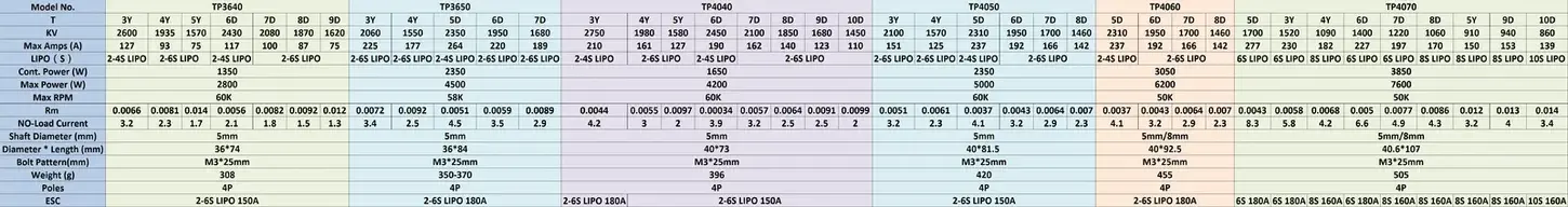

I dont believe that is true. If you look at this motor chart from TPPowerUSA you will see that the continuous wattage rating listed for each motor only changes when the size of the can changes, not the KV ratings. That being said I have not researched that particular statement and if you can show me evidence to the contrary I'm willing to consider it.
If you keep the gear ratio the same for both a 3100KV and a 3800KV motor (both on 2S) than the 3100KV will be geared for more torque since it spins slower.
A 3100kv motor on 2S will have less RPMs than a 3800kv. Were on the same page there but, the 3100kv doesn't have more torque because it spins slower. "Torque is determined by the number of winds on the armature and the strength of the magnets. A low Kv motor has more winds of thinner wire—it will carry more volts at fewer amps, produce higher torque, and turn a bigger pinion"
If you install a larger pinion gear on the 3100KV to gear for more top speed and maximum performance, it will have less speed and torque than the higher KV motor also geared for maximum performance.
a 3800kv geared for maximum performance will have more top speed and less torque than a 3100kv geared for maximum performance. Torque and speed are inversely proportional so you can't have a certain kv that has better top speed and torque than a different kv motor. you're breaking the laws of physics there.
This is also the reason the a higher KV draws more current since it's a lower turn motor and has more overall power.
Higher KV motors draw more amperage because it takes more current to turn the rotor because there are less windings in the can compared to a lower KV motor. Lower KV motors have more wire in them and therefore makes them more efficient thereby lower required current to turn the rotor. Here again though gearing can play a part in changing the current draws but again I put it to you that kv and gearing are all just a matter of tuning. You use gearing and KV hand in hand to tune the exact performance you want out of your kit. As long as you are within an acceptable range of KV for a given kit in given conditions you can make up for any lack of speed or torque with gearing.
