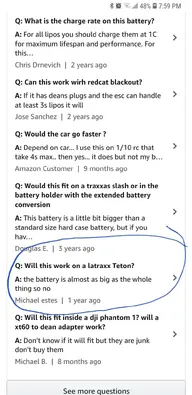

i did a google search for floureon 3s 5500mah and found this on amazon
