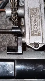

Ok, before you drive it, if you plan to, there are some serious issues.
The motor plate is badly bent. In the pic at position one the idler gear isn't flush with spur. In position 2 the pinion is pulled back away from the idler, but it appears the mesh has bee corrected somehow. Didn't that have a fixed motor plate?
At position 3, that black plastic piece has a curved cuttout in it that is supposed to rest againg that bushing boss sticking out of the left side of the transmission housing. That is to keep the motor from bending that plate lol. Alsy, that black plastic piece is dupposed to rest on the transmission, which it looks to be about 2.5mm away from it. So the motor plate needs straightened out before you drive it, and that black plastic piece needs to be resting against the tranny snd that boss.
@wickedfrog
Yes you are right on all counts. I actually think at some point in its life the gearing might have been removed and put back on incorrectly resulting in the plate being stressed. Probably by me in my teenage years because I know it has had a new motor hence the inline splices on the motor cable going to the speed controller. I think the pinion you marked as 2 need to be turned around and the others turned to mesh correctly. All the positions on the plate are fixed so I'm not sure how or why the bending has happened. It may also be why the plastic isn't flush against the motor. I'm suspecting a slightly smaller diameter motor.
If you look at the photos below the plastic is in a fixed position and installed correctly. The brass pinion gun screw is only just on the motor shaft and the 2nd and 3rd drive don't mesh as well as they could. I've actually just found the original motor and it still works so not sure why it was changed. I might put the original motor back on and try to straighten the plate.

Oh, I see now. Is the other motor a bit bigger diameter can? And the washers on those motor screws gotta go. You need flatheads in there. But before anything, the motor plate needs to be perfectly flat. And I would heat it with a torch really hot and drop it into a can of oil to quench it to try to harden it back up. Not something for the inexperienced, but It will likely just bend back if you straighten it and don't try to harden it a bit.
What's probably happened is the car took a hit on the motor plate and bent it. It looks like that black plastic piece is cracked as well.
