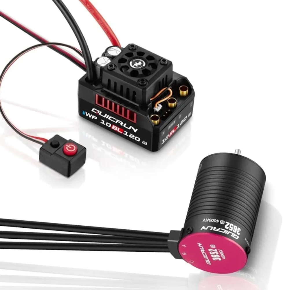

Ill emailed hobbywing. I would like to buy one but i need to make sure i buy the right stuff. I'm looking at the 10bl120 right now or something similar. I just need to find the right kv and or turns for my needs.
HOBBYWING Quicrun 10BL120 G2 & 3652SL G2 Combo (QR10BL120 G2 &3652SL 3250KV G2)​
  1. HOBBYWING Quicrun 10BL120 G2 & 3652SL G2 Combo (QR10BL120 G2 &3652SL 3250KV G2)
