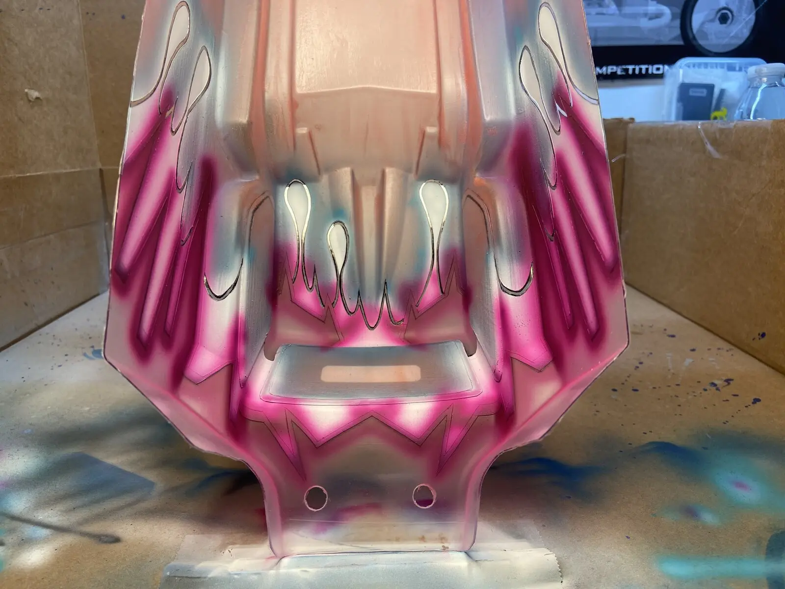

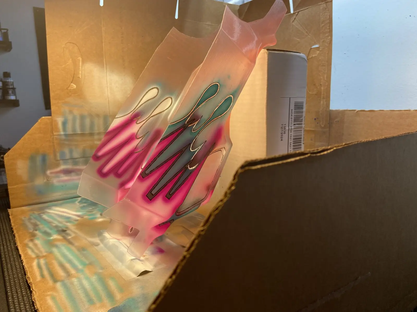

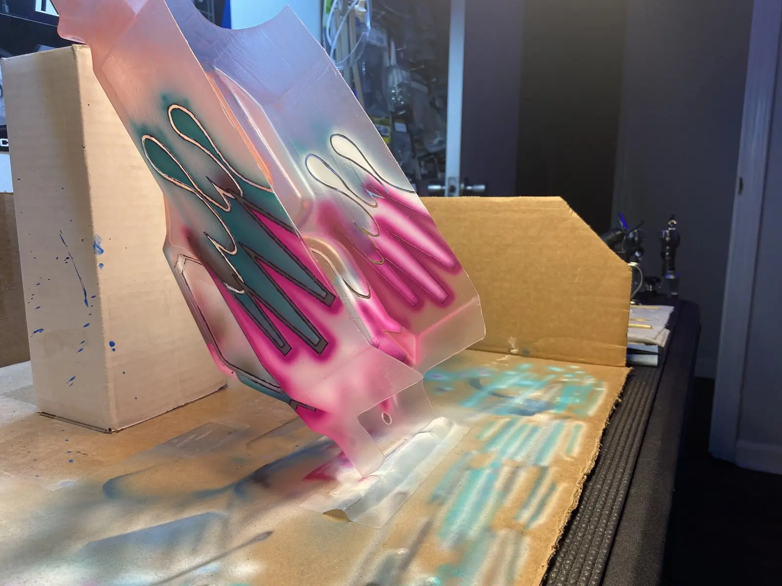

More progress… Waiting on paint/UVLS clear to mingle… Still working..

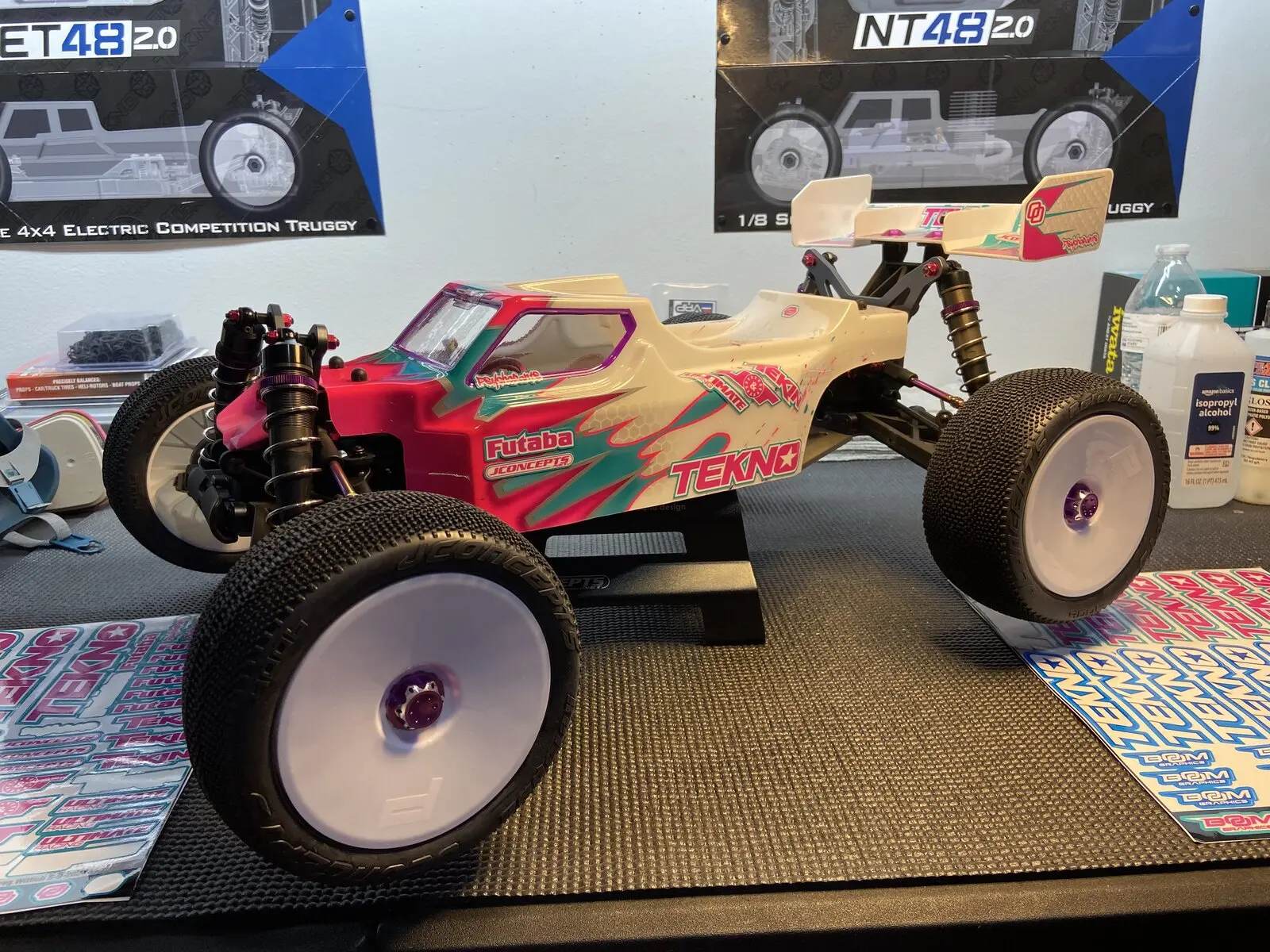

I finally stopped being a slackass, and got a lil’ sumthin’ hammered out…🤷🏻‍♂️😅
Turned out alright, and she’s freakin’ STOKED. 🤘🍻

I like the paint job! Looks good, I really would love to add one to my arsenal!
Thanks so much brother! I was super nervous about knocking this one out, as it’s Mrs. Littlemotor’s truck lol…😅 That being said-I’m definitely not gonna be stopping paintwork any time soon! 🤘🍻
It looks great, nice color choices and designs. Did you use a stencil or freehand that?

Nosir-all freehand by me, minus the faded honeycomb.. 🍻🤘

Ahhhhhhh-I gotcha now bud! That’s the liquid mask that I apply after cutting out, and washing the body. Then I draw my graphics out on the protective outer film, cut every last line, and peel each layer as needed until it’s finished.. Then I back it all with Wicked Opaque White, then Createx 4050 UVLS Clear, as a sealer. Then remove the outer factory provided overspray film, and run it! 🍻🤘
