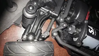

What are front knuckle arms on my e10

What can I also remove or install to getmore steering

You might measure you're Servo arm and get an adjustable arm
https://www.integy.com/st_main.html?p_catid=311
check here and find one that fits your project.
longer arm means more steering
or you can take the more expensive route and upgrade your transmitter then you could turn up servo end points on radio

I do have a spektrum And I udjusted the steering to get more but didnt do anything.
