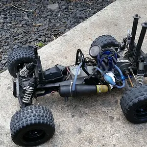

I've got a couple dirty nitros that need a deep clean.

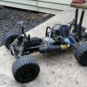

This looks like it might be a pretty straight forward resto! Not too much banged up too badly! 😎👍

It's looking that way. A lot of cleaning to be done and replace all the rusty metal screws, rods and links etc. Plus I'll see what Traxxas bling I can find. Need new servos too. And a bearing set.
I've ordered 1 pair of new aluminium shocks (the og shocks are plastic) but I may rebuild a second set.

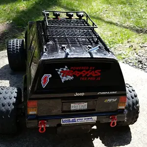

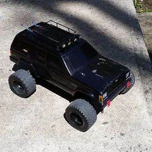

I really hate you for this body. I had to buy the new style nitro rustler.
Surprised I found one. There was absolutely zero on ebay. Had to start searching on the Google and found 1.

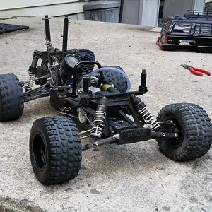

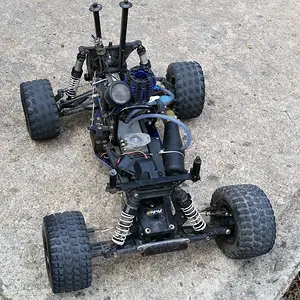

Gearbox is out.
Slipper and brake is actually good. Think I remember replacing the slipper pegs and spur once.
Apart from the old grease, the gears look fine. No dirt got inside the case. No damaged teeth at first inspection.
Diff is all good too. From what I can see, I just needs a clean and new grease. I have actually prematurely ordered a new whole diff too. 🤦🏻‍♂️ oh well.

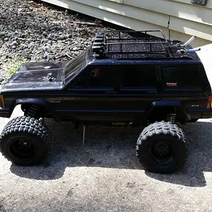

I'm copying this dude. I have two of these bodies so the green gets on the nitro sport.
