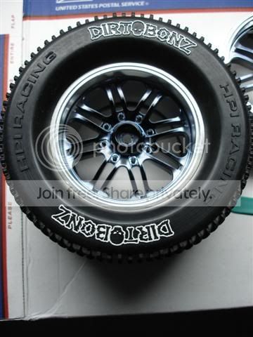

I used pactra paint, a 10/0 brush and a lot of patience. I had a set of HG aluminum rims and a new set of tires that I figured I would use just for body pics. I did the ones in this pic a few years ago and they still look really good, but they never get run, hell the tires aint even glued to the rims. It's tough to see them in this pic so I'll try and get a better pic of the tires up close.

Beautiful tires... both of you. Mine are huge with big lettering and a couple of stars, all the way around. It would be an endless process with a brush, that's why I subcontracted them out.
