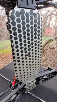

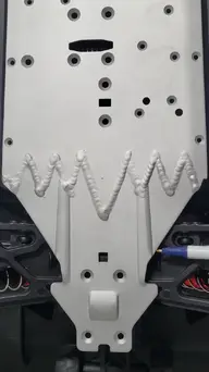

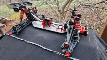

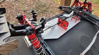

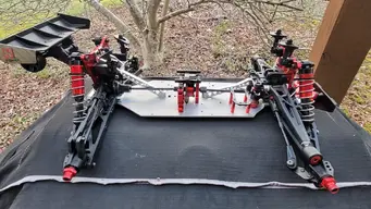

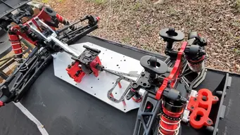

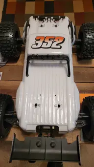

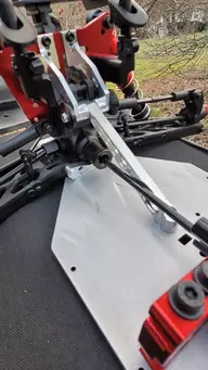

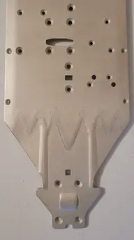

Arrma Kraton V5 chassis CNC lasered 25mm shorter & re-welded to make a custom 352mm wheelbase.
Started with a new Notorious V5 slider. Spektrum 4074 2050kv motor & Spektrum 150a Stealth ESC. Power HD 40kg servo. Tekno 14t pinion. All aluminum hinge pin holders. Aluminum chassis braces. Tower to tower brace custom cut down to fit. Arrma EXB Kraton shock towers. Aluminum bellcrank & EXB ackerman. M2C rear tower braces. 3drc TPU wing mount. Aluminum center diff case. Corally Asuga 110mm rear dogbone to accommodate the shorter rear chassis length. 60/375/40 F/C/R diff fluids. Dual 40mm motor fans.

- The custom chassis. I designed the layout for the CNC laser. I made a DWG after I blueprinted the rear chassis. Finding the correct length of rear center dogbone.
