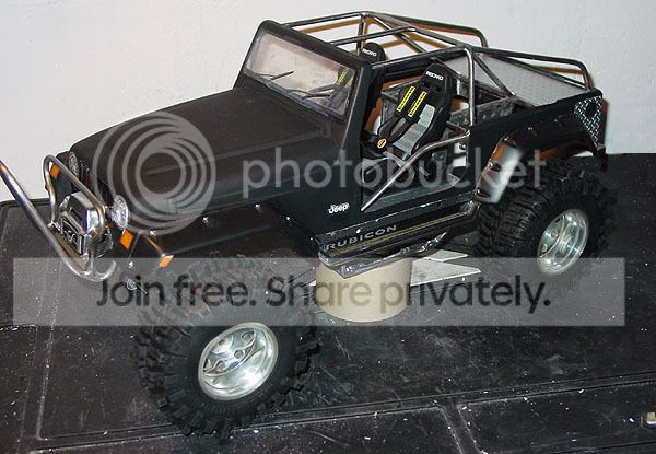

For flat black just use Krylon Ultra Flat black, and paint it on the out side of the body, lightly scuff it first. It adheres great to lexan and does not chip off after it has dried. It really holds up well, I have used it on several bodies with the most recent being my Jeep body for my tuber.
