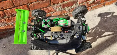

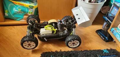

Here is my Hyper 7 from start to finish found in a damp outhouse it had spent 6 years in decided to give the old girl a new life.
Hyper 30 turbo - 16T clutch bell - 46T spur
Fastrax pro race efra 2062 (jammin jp4 rebrand)
Answer-rc alloy clutch shoes
Carbon servo tray
Carbon front top plate
Alloy center diff plate
Alloy shock towers
Twin disk rear brake - single disk front
Centro max dual stage air filter
Spider diffs front & rear
Savox Sc0254mg Throttle servo - Alloy servo horn
Savox Sc1201mg Stearing servo - Alloy servo horn
1600mah rx battery

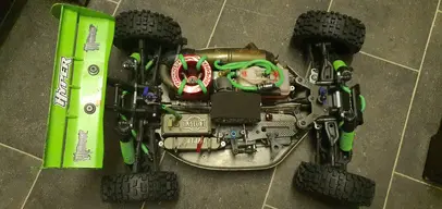

Thanks still a few bits to do I want a quad clutch system and I need a center spider diff. I want some alloy front/rear uprights and alloy chassis braces then I will be 100% happy with her.
Howdy an update on the Hyper 7
Centre spider diff now fitted
Answer 4 shoe flywheel & clutch
16mm Big bore shocks
Hyper ST Pro Bumpers
Alloy wing support bars
Evil green side guards
New carb
Still to do - Hyper ST Pro shock towers & The ring muffler support in red and then she will be complete and ready for next year. She gonna get a good thrashing as soon as the weather improves.
Shes lookin good man!
Thanks just added Hyper 7 PBS CNC chassis braces replaced the carb on the Hyper 30 engine with a Team Orion CRF carb. Now running a Jammin Jp3 with proper manifold - so now my parts list is this
Hobao Hyper 30 Turbo (Orion CRF carb)
Answer-Rc Airflow 4 shoe clutch system (medium springs)
16T Hobao CNC vented clutch bell
Centro 02 max dual intake air filter
Hyper ST pro shock towers F/R
Hyper ST Bumpers
Zd racing 8001 - 8002 Big bore shocks
Carbon servo tray
Alloy centre diff plate
CNC Chassis braces (PBS)
1600mah receiver battery
Jammin Jp3 in-line exhaust
Spider diffs F/C/R
Rc project The ring muffler support
Hyper 7.5 hinge pin replacement (bolts)
Savox SC-0254MG - Throttle servo - alloy servo horn
Savox SC-1201MG - Stearing servo - alloy servo horn
Alloy wing mount supports
Dual rear disk brake & Ferodo brake pads single front with Ferodo pads
CNC Rear uprights
CNC front knuckles
In total I have spent £465 on upgrades 😂🤣 bit crazy could have bought a newer rtr Buggy/Truggy but this Hyper 7 is one of a kind at least.

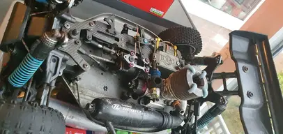

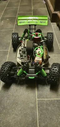

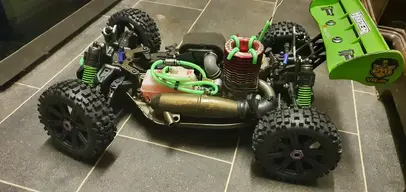

Ok so had a few nightmares I gave up on the Hyper 30 so many tuning issues for no apparent reason checked and changed almost everything. I did purchase a Picco V1 21 engine but it was sent out via My Hermes and they have lost/stolen it so I had to find another motor I came across a Picco P3-R Evo Turbo SG .21 for £120 brand new never ran with a 4 shoe clutch and flywheel fitted and a glow plug so I bit the bullet and bought it safe to say since my last update there have been a few changes. Ready to take to my local track after a little more gentle break in.
2001 Ofna Hyper 7 (parts list)
Picco P3-R 21 Evo Turbo SG £120
Tetra clutch/flywheel (medium springs) £0
16T Hobao CNC vented clutch bell £13
Centro 02 max dual intake air filter £10
Hyper ST pro shock towers F/R £40
Hyper ST Bumpers £9
Zd racing 8001 - 8002 Big bore shocks £25
Carbon servo tray £20
Carbon front top plate £15
Alloy centre diff plate £10
CNC Chassis braces (PBS) £36
1600mah receiver battery £10
Jammin Jp3 in-line exhaust £35
Spider diffs F/C/R £105
Rc project The ring muffler support £12
Hyper 7.5 hinge pin replacement (bolts) £7
Savox SC-0254MG - Throttle servo £25 - alloy servo horn £5
Savox SC-1201MG - Stearing servo £25 - alloy servo horn £5
Alloy wing mount supports £10
Dual rear disk brake & Ferodo brake pads single front with Ferodo pads £40
CNC Rear uprights £35
CNC front knuckles £35
CNC hex’s x4 £8
Hobao extended shock stand offs £8
Hobao Evil green side guard £10
Hobao evil green rear wing £10
