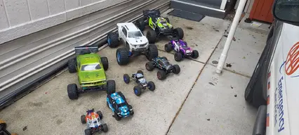

I have a shredder and after market body's for that longer chassis is almost impossible to find. 1/5 scale will fit best but you'll have to make some modifications. I used the proline barracuda drag body on the shredder here. It was not a perfect match but made it work a little short on the wheel base and a lot of trimming. 1/5 will fix the wheelbase issue but then it's going to be wide. So ya kinda gotta give and take
