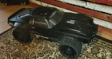

I built my felony into a 8s xmaxx powered 60+mph dirt basher and it gets broken because I beat the hell out of it. I keep a few spare parts around for this one 😆.
