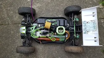

My bit of fun so far lol....

St need a new exhaust as that one looks terrible...

Wow! That's SUPER clean!!! Nice job!!!! One thing I need to point out tho... The muffler!!! The sent may seem irrelevant... It is not unfortunately. The way the exhaust works on these is that there is a 'pulse' generated by the shape and design or the muffler. It causes reverb at a specific frequency. That is used as both back pressure as well as thru the hose that runs from the muffler back to your tank. To get you running, it is likely that you won't have any problems. When you get it dialed in and running proper, you will likely notice that it is not reaching its potential. It's at this point that you need to make a decision as to whether the exhaust is impeding your performance and if you want to live with that or not. Personally, it would drive me crazy to know that I CAN get better performance with a new pipe. Therefore, it would be too of the 'need to have' list!
Be sure to check over your air filter as well, just to make sure that you have no holes etc. It's difficult to tell on the screen on my phone but there appears to be a little piece missing. I would address that asap as well. Just a little diet goes a LONG way towards destroying and engine!
When you stripped the engine, did you seal it?
Now that my nit-picking is done, that rig really looks great!!! :thumbs-up:

\Lol.... that pipe looks like an old copper still!.....:D
It's Def cool looking! It MIGHT even work right or better than stock shape! :hehe: time will tell on that one!
I wonder if rc4wd has made a scale still yet???!!! :hehe: :wasted: If it's done right, you could even run the cars on some high powered shine!!! :celebrate::bowtothercnt:
Yrah its on my to do list tje exhaust.... but i like the look of it its pretty cool I've not seen another one like it but if it's not working right the it'll have to go.....Now that's a thought running a nitro car on some 150% proof shine lol.....
