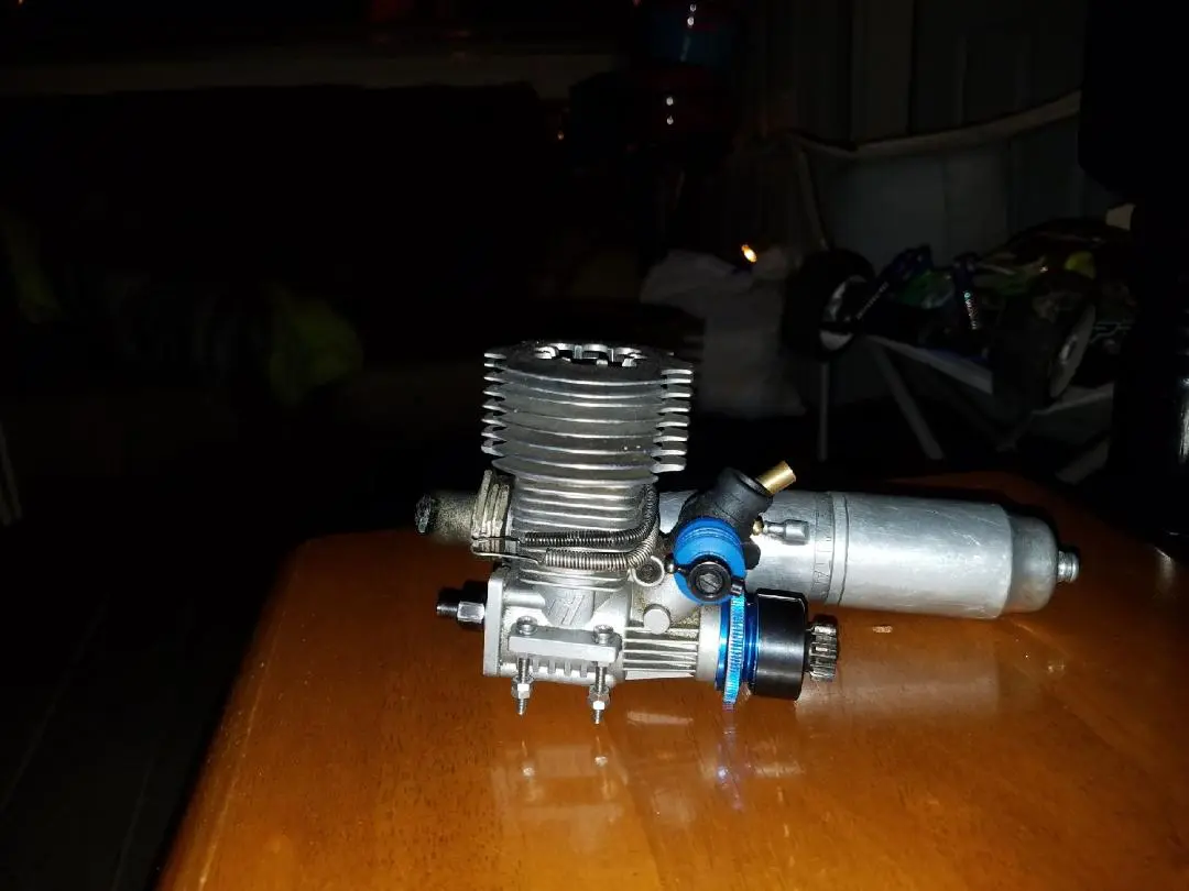

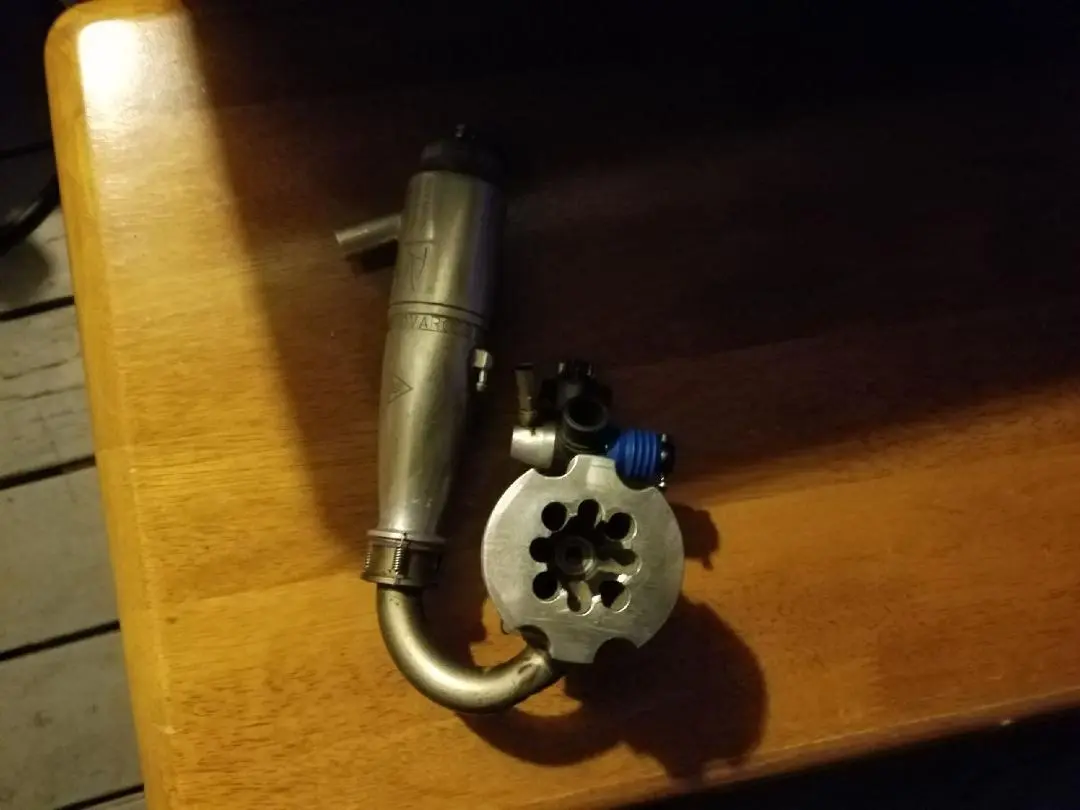

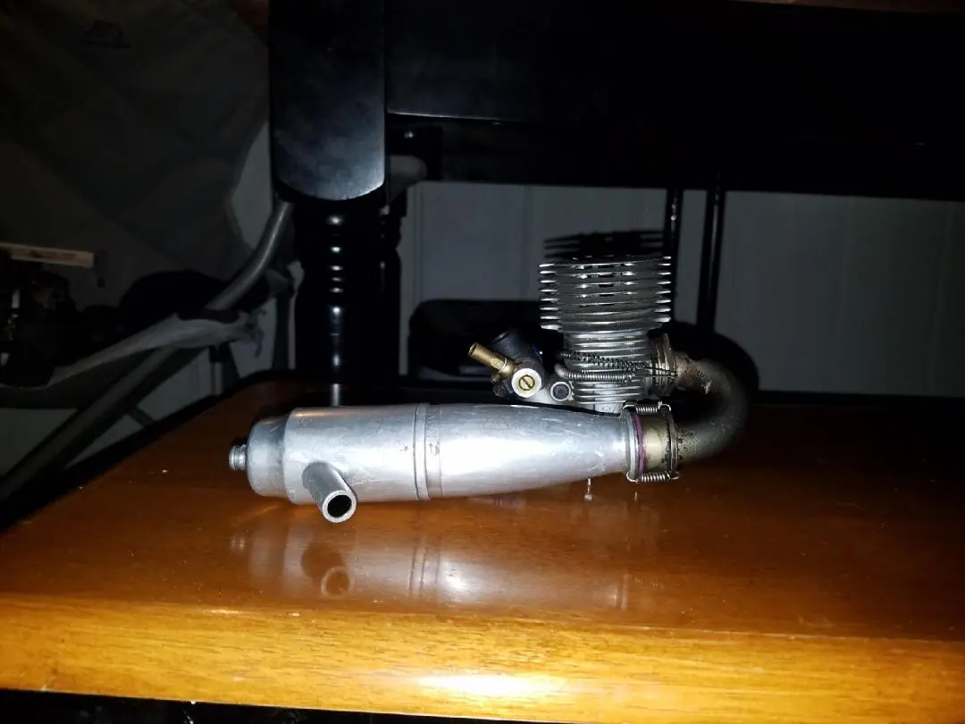

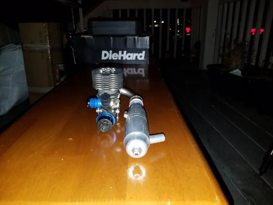

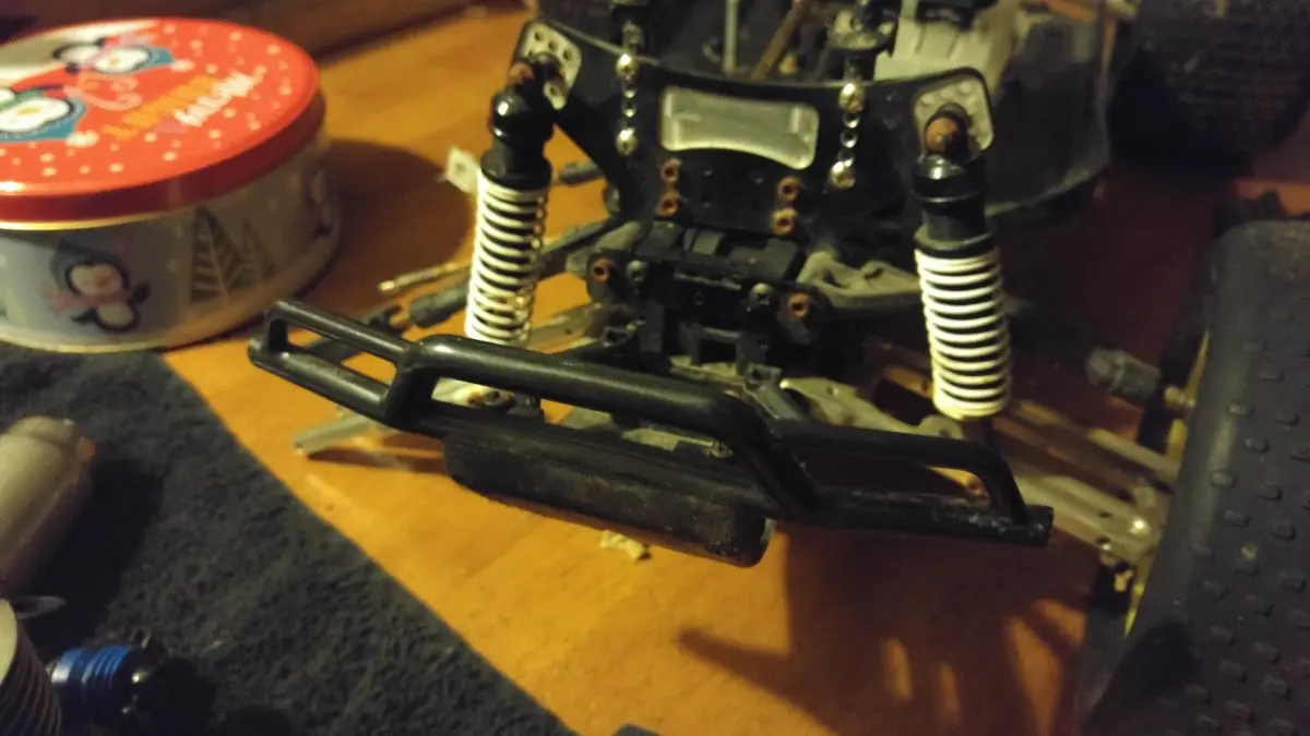

Hey guys. Got a good deal on a Kyosho, and an extra rig that had all the parts in a box. I have no idea what
kind of car it is, its huge. Just wondering if anyone could help me out. This thing is a little older and the Motor has
No identifying marks except for an "H" on the side. The H has a slash through the upper left quadrant. Just trying to figure this big guy out my son and i are starting to put it back together. I can take a picture later when i get home if it helps. Thanks Guys for any info.
I think its an HOBOA, not sure if its good bad or what.. If anyone can confirm this and maybe give some info on how i would find out more about this particular motor that would be great.
Can you post up some photo's of the vehicle it's in? Guessing it's just an RTR engine that came in it as many older "racing" engines didn't have a pull-start on them, which it looks like this one has remnants of.

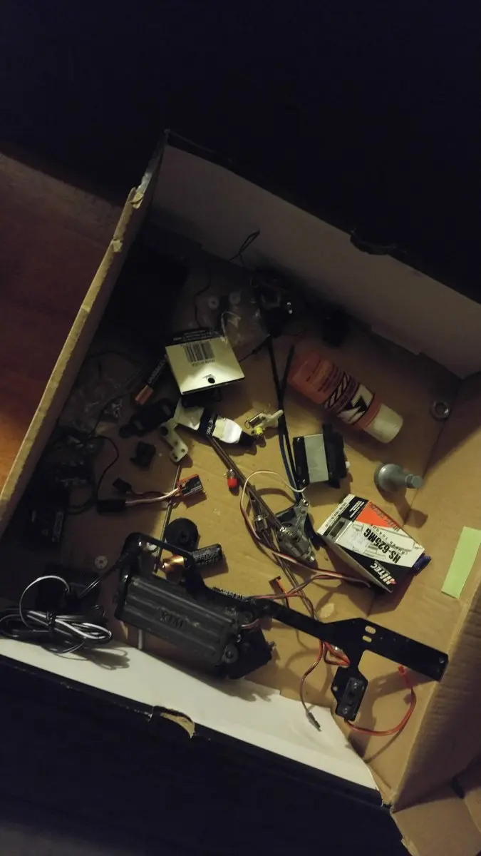

Sure once I get home. This motor was never in this vehicle per say. It came as a chassis with some suspension and a box with all kinds of parts and the motor. Came along with the kyosho. Pics as soon as I get home. Thank you!

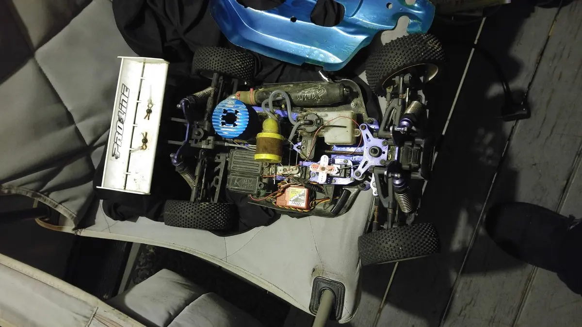

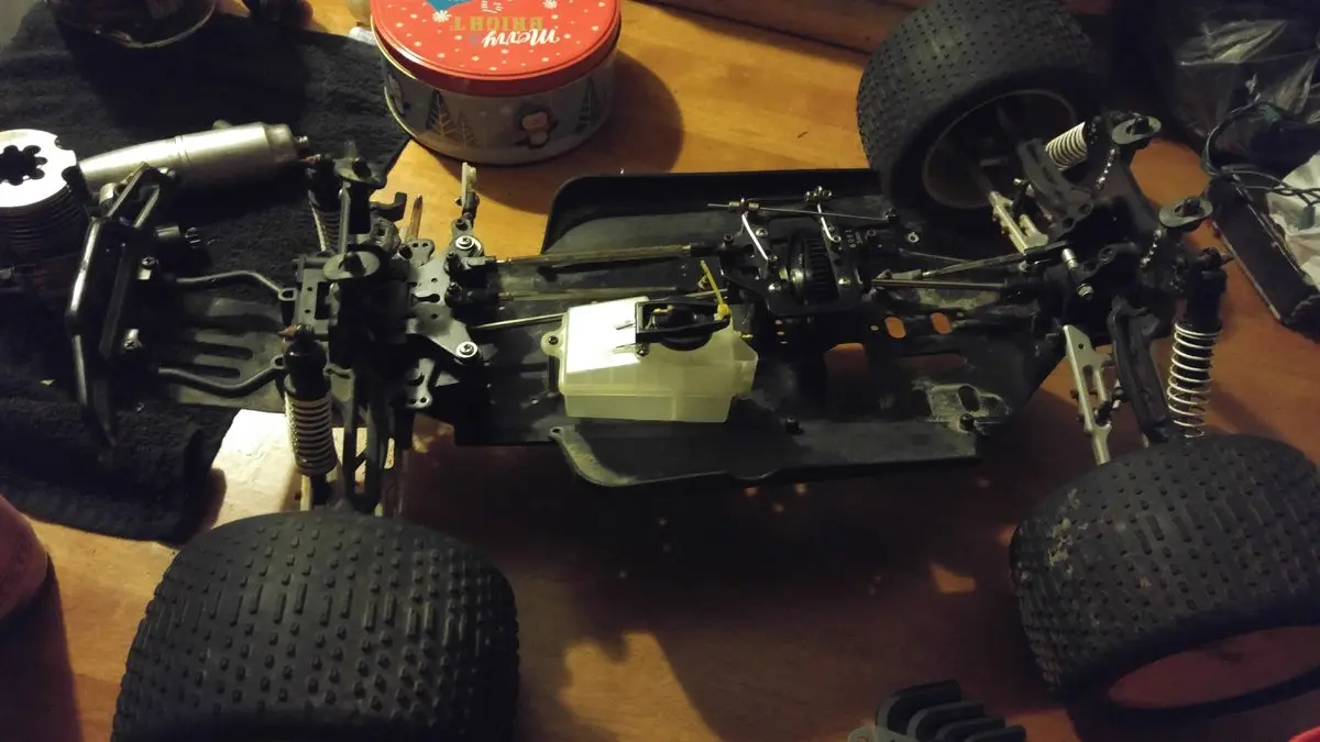

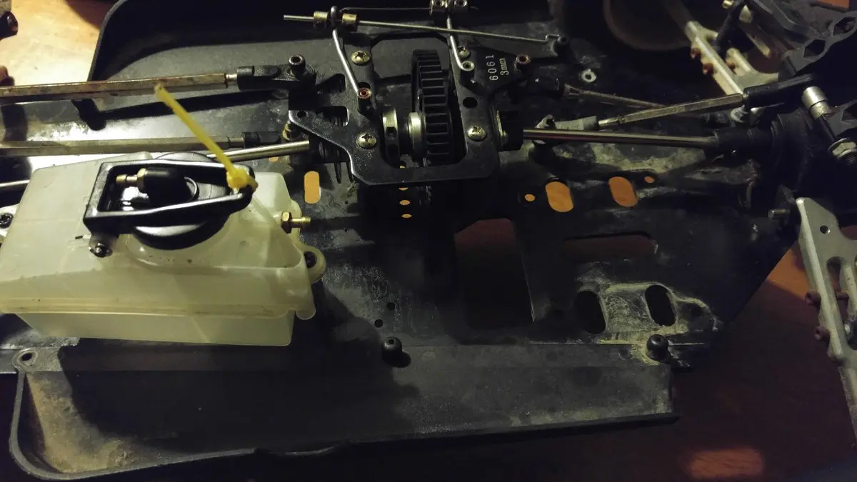

That is what I figured. My kyosho is separate tho. It was a complete rig. All the other pics are what came with it. I have scoured the chassis and I find no marks. With one exception, there is a tiny metal piece up front that has a "0" stamped on it. I'm sure it's nothing. After messing with the motor alignment I realized the mounts don't line up. The holes would have to be drilled in order for it to mount. I'm very lost. If I were to salvage it would it be worth it? The motor doesn't seem much bigger than my kyosho motor and it's a much smaller scale. Would that motor even push the big chassis? Sorry for so many questions just trying to figure out what to do....
Pretty sure the truck is an XTM Mammoth ST with something weird for the center spur. It came with a crappy 2 speed that liked to break itself and many replaced that with a center diff. It was a big truck for the time, mostly due to the overly long bumper/skid and chassis deck. Fuel tank was huge and ran forever. The diffs are weak as well, if I recall, they ran planetary gears vs spider. Also, XTM aluminum was very soft. Things bent easily. I had one for a while.
The tank on yours doesn't look original and with the battery/receiver box missing, it's hard to be sure, but it really looks like a mammoth st to me.

Is that the 290 cc fuel tank?
Omg thank you. That's what it is. Looked through the box and the battery case is identical to yours. Probably should have looked earlier!
