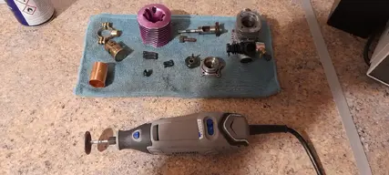

Well I have a hpi k4.6 it's still runs but hard to get a good idel and cuts off a lot .the pisto is way past tdc I also have a force 3.5 and a hpi bullet 3.0 engine that basically new but it's ner top of the bloddy cylinder I don't understand it I removed 2 shims last night and going to take it out to see how it goes it was cutting outalot aswell
Look at the crank case it's brand new man there been about 4 liters of 20 out through it just so don't know how it so worn 😅 still have food compression but can be a pain to get a good stady tune on 🥺

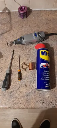

Cheak it guys worked a treat it now pinching where it ment to this should be a major part of maintenance works so well if it done right

I'm not sure if using the split ring is a good idea. Unless you can tighten both side at the same time. That's why everyone uses a hose clamp.. but yeah thats the idea. But it looks like you got to get the piston higher past all the ports. 4mm from top of sleeve.
And you definitely don't need much. If possible. Should have measured the piston circumference. Then the sleeve inner diameter. To see much you need to pinch it.. or you did do that

Yes cheaked all that so that why I cut it at 5 mm it worked great bro 👌
the point of the split coller is to allow some room for compression My new pinch point is good and have really good compression bro

By hand bro just titein the screws evenly fue links guys
