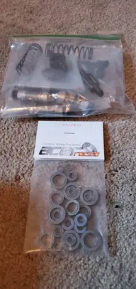

Well I ordered the 3.0 front arms and the 15° spindle carriers for my second db. I also ordered a set of tenacity skid plates for it and rear aluminum diff bearing holders along with the new cage I needed and shock shaft. Oh I almost forgot I ordered the tenacity lightened/heatsink motor mount for it too.
Now my original db pro I went ahead and ordered the carbon fiber shock towers front and rear from the 3.0. I also ordered a complete set of 3.0 shocks. It will be pretty much a 3.0 without being able to move the center diff☹ Though I my have a fix for that.?
My second db I noticed the front drive shafts were wearing a bit. So I replaced them with the stock ones I pulled from my db pro(i installed the 3.0 ones on the db pro) I also noticed the front wheel bearing were just about shot(so I stole the ones off my db pro) and ordered a full set of ceramic bearings for my db pro. Can't wait for it all to come in.

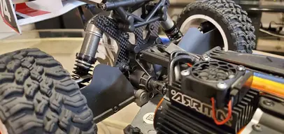

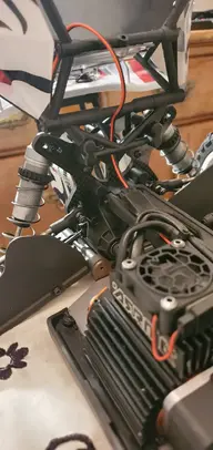

Ok the shock towers showed up today. Well the rear tower is 1mm thinner and slightly shorter where the body mount goes. So I came up with a plan to get it to work. I think it came out well. This is starting to really deserve the title "PRO" (looking back it would had been cheaper for me to buy a scte 3.0 and retrofit the db pro body and cage to it but this was much more fun and it has all metric hardware)
The shocks will be here Thursday and the bearings Friday according to USPS tracking. That gives me Thursday night to build the shocks and Friday and Saturday night to install all the bearings.

Can someone post a pic of how the stock light bar wire was ran at the back shock tower? Thank you

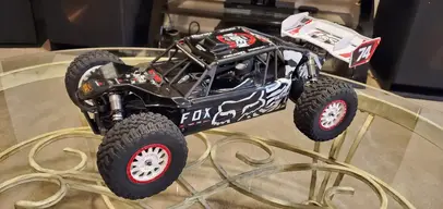

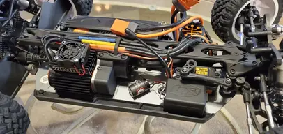

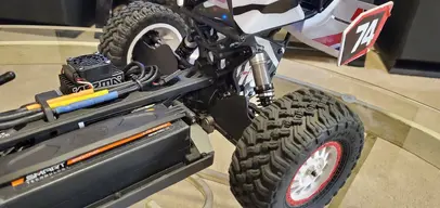

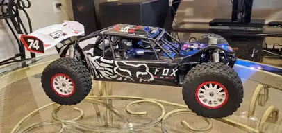

All finished up. The db pro 3.0 is finally done. Well may need some longer springs. These are struggling

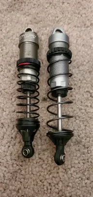

Well. I ordered some hot racing spring sets front and rear. I didn't go with the losi sets as I have read to many people complain about inconsistencies with them. So I figured I would try hot racing for 1/2 the cost. I ordered some shock oils too(35, 37.5, 40, and 42.5)
I am converting my 3.0 shocks to take 2.0 springs. So both my db will be able to use the spring sets
I did order some 3.5x48 MM shock shafts for the front of my red db. The stock front shock has a 3.5x42mm. The 3.0 shocks are 3.5x52mm with the same size shock body. The 52mm shaft I dont think will work right in the stock db front shock as it needs room for the bladder. So I figured the 48mm would work great and still add some more movement up front.
